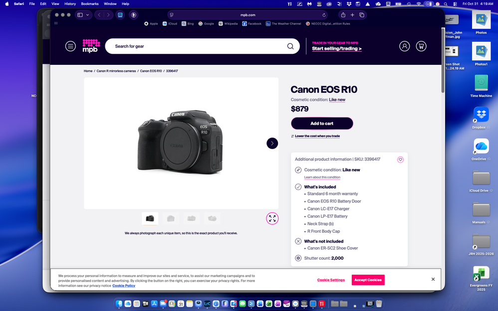

I recommend you stretch your budget a little and get the R10, particularly if you are looking at getting the zoom lens. Larger body size.
Both of these companies are reputable and very honest in their ratings of condition.
I have purchased several RF lenses from both of them.
Canon refurbished gear is also a good source, but Im checked and they are out of stock on the R10.
Screen Shot 2025-10-31 at 04.19.33 AM.pngScreen Shot 2025-10-31 at 04.23.37 AM.png
