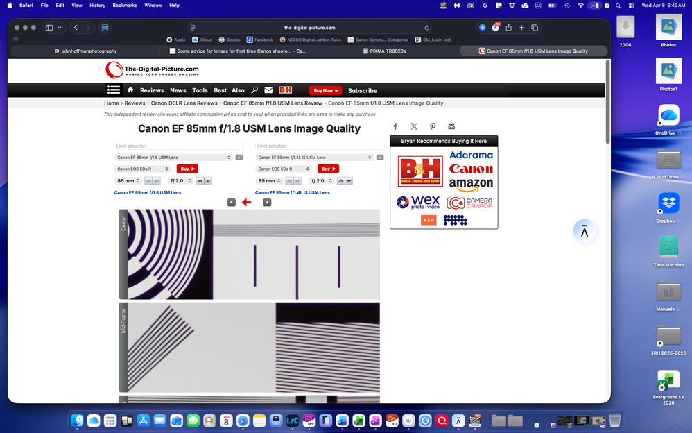

My wife has a bit of an unconventional setup; her primary portrait lens is a 55mm Micro-Nikkor 2.8 that she uses on a APS-C body, which is about an 83mm focal length. She loves it due to its sharpness, which I believe is well regarded in the Nikon world. I would guess the 85mm f/1.8 would be the natural choice, but how does it perform related to its L brethren?

You can use this tool to examine comparative test chart images. The L lens will be sharper and IS would be a benefit in low light.
