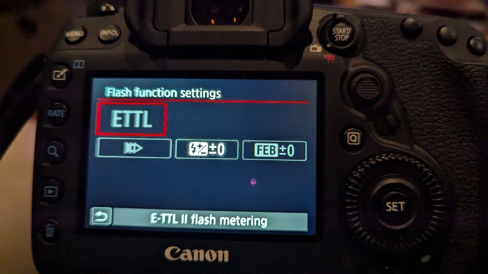

The Macro Ring Lite MR-14EX will work on the EOS R8. Just slide it in the hot shoe and lock it and it will work and be fully compatible. If it’s the version II you can also control it from the External Speedlite Control Menu in the camera. The older version cannot be controlled this way. All setting changes must be done on the Macro Ring Lite itself. Flash Exposure Compensation can be set with the camera menu though. Below is a picture showing how older speedlites and Macro Ring Lites show settings. Note functionality IS LIMITED with older models. Options grayed out or missing are NOT settable from the camera’s menu screen.
Post 2011 Menu system EOS 5D Mark IV (released in 2016)
