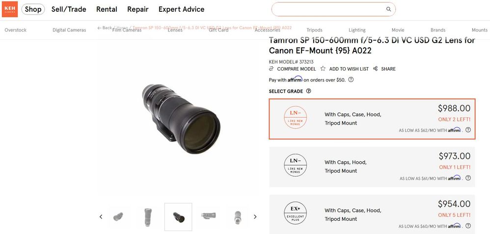

Hey WingMan71, welcome to the site.
Limited budget is a pretty loose term so I will suggest the Sigma and Tamron 150-600mm which many use for wildlife with a focus on birding. Sigma you have the Contemporary and Sport and on the Tamron side most say the SP 150-600mm f/5-6.3 Di VC USD G2 is a slightly better lens. Either will give you great images. I shot the Sigma for a long time before going RF and once I made the move to an R body grabbed the 20-800mm and my Sigma now is pretty lonely. KEH and MPB both have some lenses in stock that you can view to see if they fit into your budget.
The link below is to a thread about the EF 100-400mm that you may find interesting.
Similar Conversation on zoom lenses
[Commercial links removed per community guidelines and replaced with screenshots to act as visual aids.]
