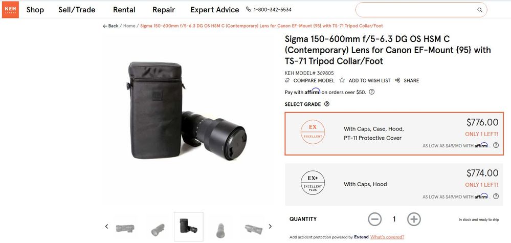

[Commercial links removed per community guidelines and replaced with screenshots to act as visual aids.]

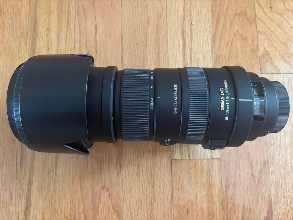

I found a used Sigma DG 50-500mm f/4.5-6.3 APO HSM Canon mount lens locally for a good price.
What do you think about that lens for birding at anywhere from 15 to 20 yards?  Sufficient, or should I hold out for a 150-600mm I can afford?
Sigma DG 50-500 f-45-63 APO HSM Canon Lens-1.jpgSigma DG 50-500 f-45-63 APO HSM Canon Lens-2.jpg
WingMan7,
that lens was announced by Sigma in 2000 and released in 2001, is no longer in production and discontinued. It's a 24 year old lens and possibly can't even be serviced any more let alone update the firmware. The Sigma 150-600mm is still in production in the Contemporary (C) version and supported by Sigma.
Personally I would put away a little more cash and get the Tamron or Sigma 150-600mm, the 100mm on the long end will be nice for smaller wildlife. Also, the one in the picture looks a little bit worn.
