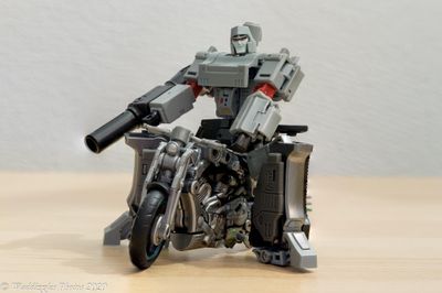

If you already own a lens that’s sharp enough for your needs, then maybe you should explore focus stacking multiple images. This is a focus stacking of several images (8?) from several years ago.
It was captured using a 6D2 and the EF 100mm f/2.8 IS USM. No special lighting gear. Just a photo of a toy sitting on a desk.
Each image in the stack was actually a mini-stack of several images to cancel out noise.

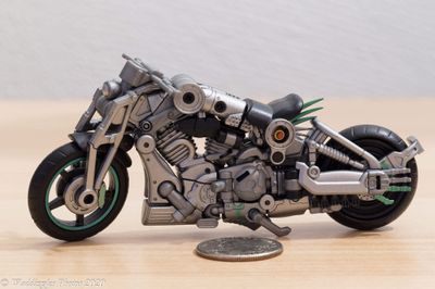

08-13-2025 06:30 PM - edited 08-13-2025 06:35 PM

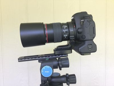

More fun with toys. I don’t recall how many total images. But this was a deeper stack of mini stacks. I needed far more DOF than the previous image, so I needed more samples to move the focus plane a greater distance.
I like to use a nodal rail as a horizontal extension arm. Way more stable! I can touch it and it doesn’t move.
