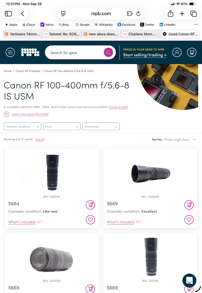

Consider these:

Daylight is much less demanding of the gear but be sure that she isn't likely to become interested in shooting nighttime sports in the near future before buying. For daytime, the gear recommended by JR Hoffman should be fine; for night use a full frame sensor camera such as a R6 or R6 II would be a better choice for low light use and a lens with an aperture of preferable f2.8 or at the least f4 would be the proper choice.
