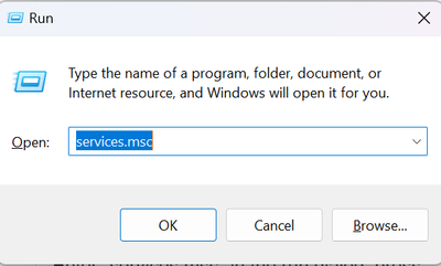

Try the following.
When the error dialog pops up...
Windows+R key
Enter "services.msc" in the run dialog, press ok
Scroll to service EWCService. Right-click on it and select properties. Change start up type to disabled. Now select stop service. Once the service stops, press the re-try button on the error dialog. The install should complete. Change the service start back to Automatic, save. Restart the machine and test.
I have not tested this myself.

04-07-2023 02:50 PM
Tried this and still get the same error. So, I tried to manually start the service and no matter what state (automatic, manual, automatic (with delayed start) I could not manually start it. Got a 1053 error, "The service did not respond to the start or control request in a timely fashion". So based on Googling I ran an sfc /scannow but no errors were found. The next step will be to edit the timeout in the Registry and see if it is set properly. At a loss beyond that. I see that a couple of others are now reporting the same problem with much newer machines.
