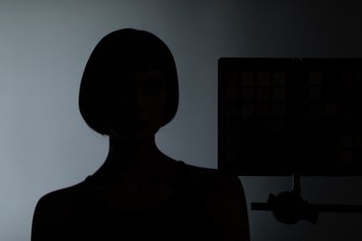

1. Initial black frame to ensure that no ambient light was affecting the scene.
Reverse Gel - Initial Black FrameReverse Gel - Initial Black Frame

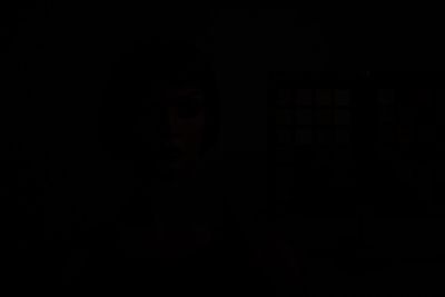

2. Key light only
Reverse Gel - Key Light OnlyReverse Gel - Key Light Only

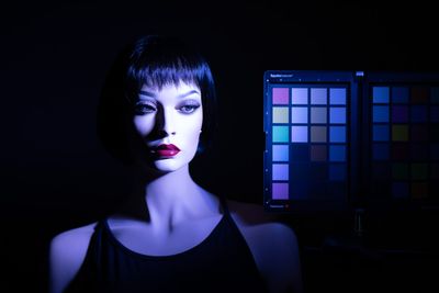

5. Key light with double-strength CTB gel.  Power increased to 1/3 stop over 1/8 power to compensate for the 3.3 stops of light loss.
Reverse Gel - Adding the GelReverse Gel - Adding the Gel

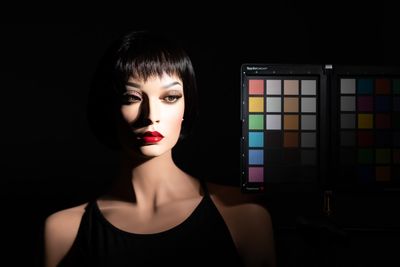

6. Capturing a gray card image for use with a custom white balance.  Power was reduced a bit of the key flash so as to capture a more saturated blue.
Reverse Gel - Gray CardReverse Gel - Gray Card

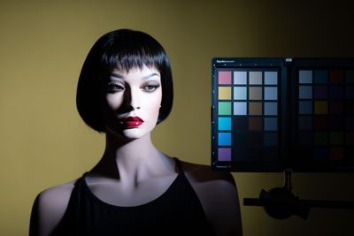

7. Final image using the custom white balance.
Reverse Gel - Final ImageReverse Gel - Final Image
