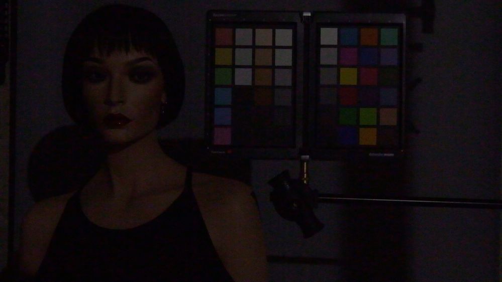

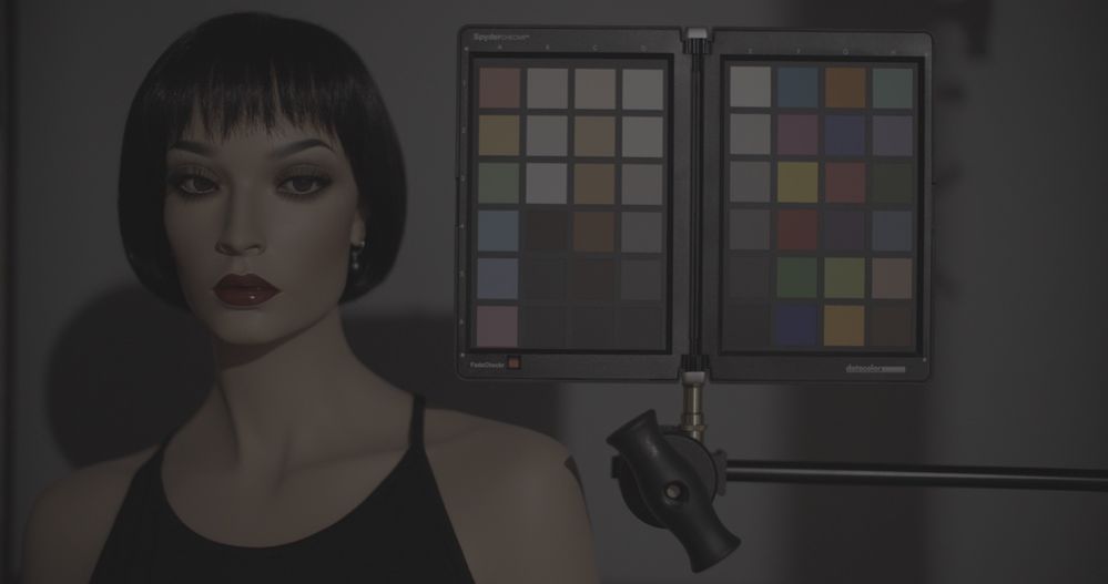

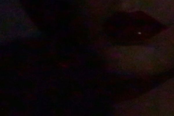

Here are still frames from video equipment showing various results of attempting to film an extremely dark scene.  Same would apply for photography.
The scene was my basement with single 60 W equivalent LED bulb lighting the scene.  No other ambient light.  The bulb was around 8 feet away from the subject.
First is a Vixia HF G50 that was at its absolute limits (max gain/ISO set):
Next was the with an EOS C70 using an RF 24-70mm f/2.8L lens at f/2.8
Finally, the same EOS C70, but now with the 0.71x adapter with EF 50mm f/1.2L lens.  This setup had the light capturing ability as an f/0.9 lens.
Details of the three frames are below:

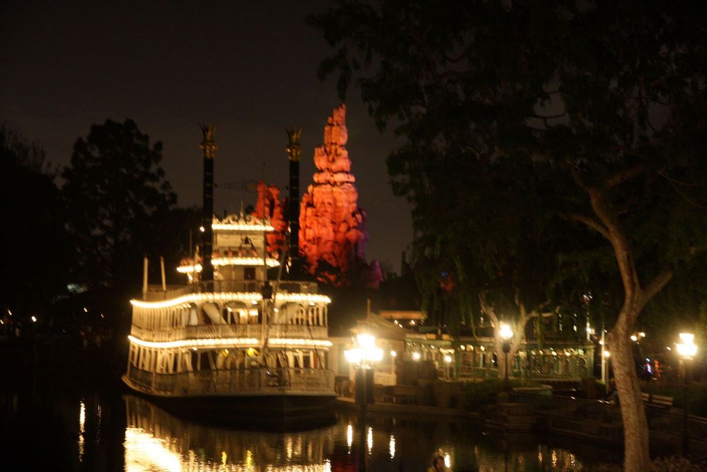

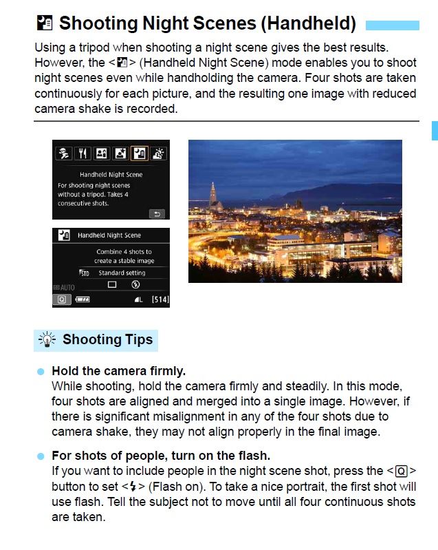

Shoot, depending on the Camera, the camera can do this!
It is called "Handheld  Night Scene" Here is the manpage for my T6S:
Not the best example:
