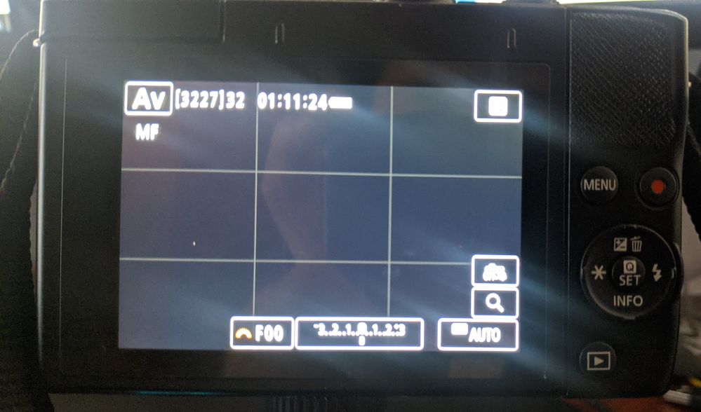

I had my Canon EOS M200 for about 2 months now, and I'm seeing a white and colored spot on the LCD. This is only showing on live preview but not on the actual photo, JPG file, and menus. I just noticed this after a warning that my camera is overheating after over an hour of live stream.

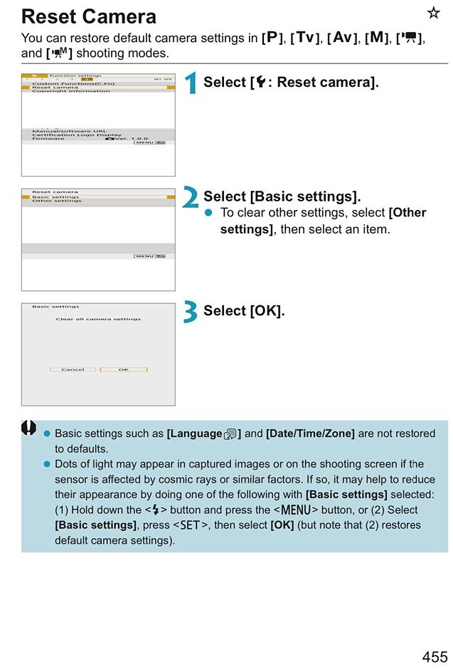

I just found the solution to my problem. Just Reset Camera from the Menu, Basic Settings!

Thank you so much!!!!!! This fixed what I thought were dead pixels on the lcd and the sensor the day before I wanted to go out and take some night shots.
