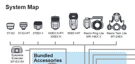

Here is a detail from the system map, but don't consider this an exhaustive list of flashes - especially if they are newer than the SL3!
