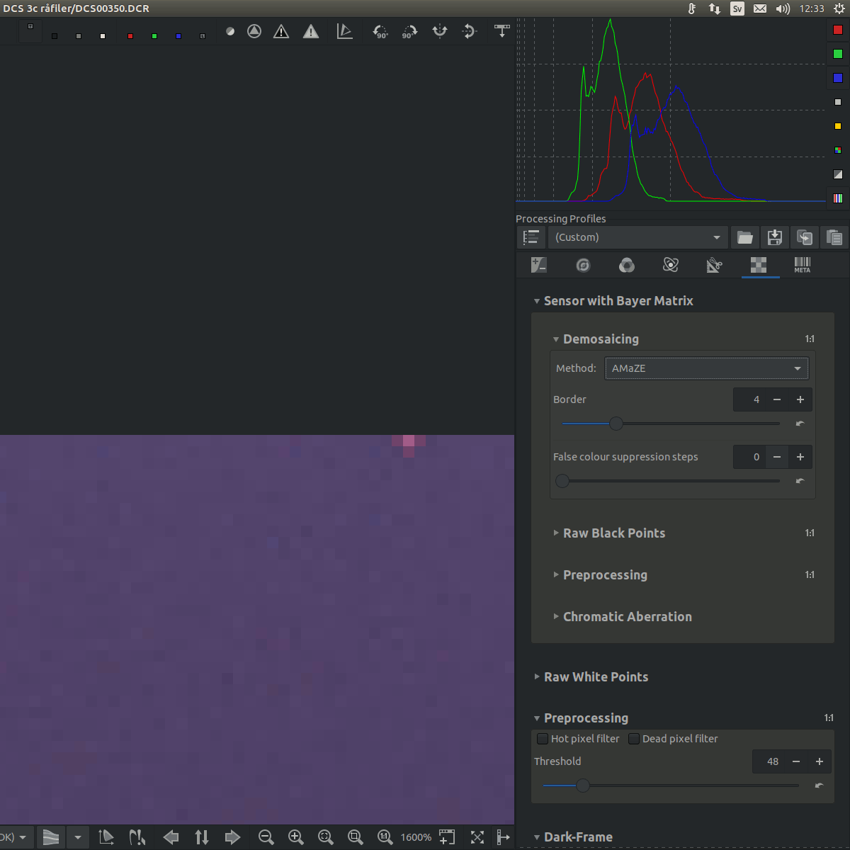

About star eating and hot pixel removing, check the GIF file below. If the star is small enough to only affect one pixel in the Bayer filter, then it is possible it will be removed. My experience is that this normally isn't a problem.
