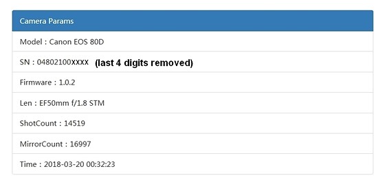

There are various 3rd party programs that can give you the shutter count of your camera. Most will charge you a small fee of about $5.
I have used eosmsg.com to check my 80D and it says that it also supports the T7i.

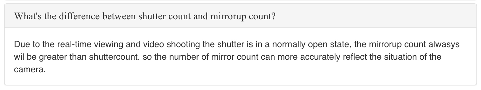

eosmsg gives 2 counts. “ShotCount” and “MirrorCount”.
