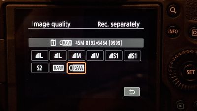

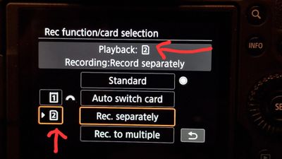

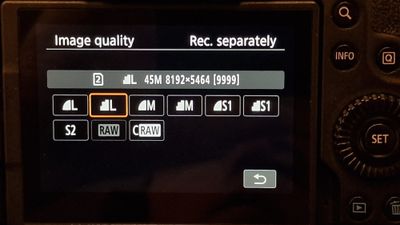

I came across this post as I was having the same issue. However, I transmit over FTP with the SET button only the photos I like. Originally, it kept sending the CR3 but then I found out, that the SET button transmits the photo you are reviewing (playback). After some searching I found a setting in the recording settings that allows to do the following:
Record CR3 on the cFast:
Record JPEG to the SD card:
Then set the playback to use the SD card:

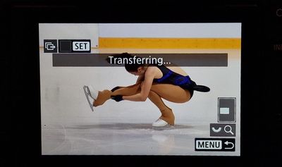

I have the FTP server running on my Windows 11 box (FileZilla Server) and when I push the SET button on the photo, the JPEG is transmitted to the correct image folder and shows up like magic in my Exposure X7 photo editing tool.
