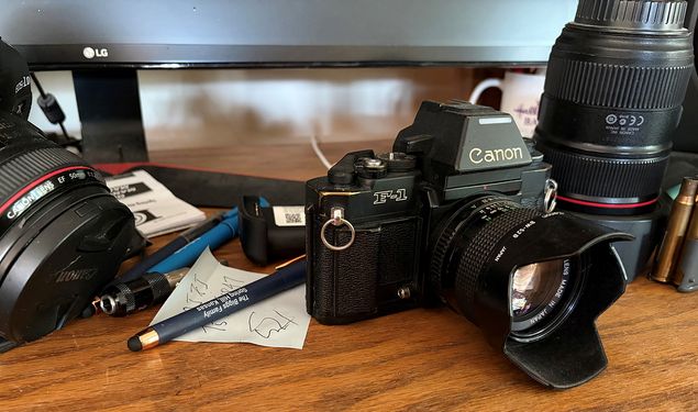

I got this ole F1n in the early 80's. That's 19 not 18.
It is my friend and it has been with me to the deserts of the great southwest where the temps hit 120+. It was with me through a white out snow storm in the Rockies. All the way down to the beaches of Miami. Both it and I show our wear but here we are. We never missed a beat together.
Your camera is made to use.
EB
