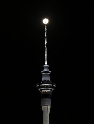

In the following example, I deliberately allowed to moon to blow out to get the exposure on the tower structure correct, so it was not the dominant element in the image, but contributed to it by being located at the top of the tower.
Canon EOS 5DsR, EF 100-400L II@ 128mm, f/9, 1/15sec, ISO-2000Canon EOS 5DsR, EF 100-400L II@ 128mm, f/9, 1/15sec, ISO-2000

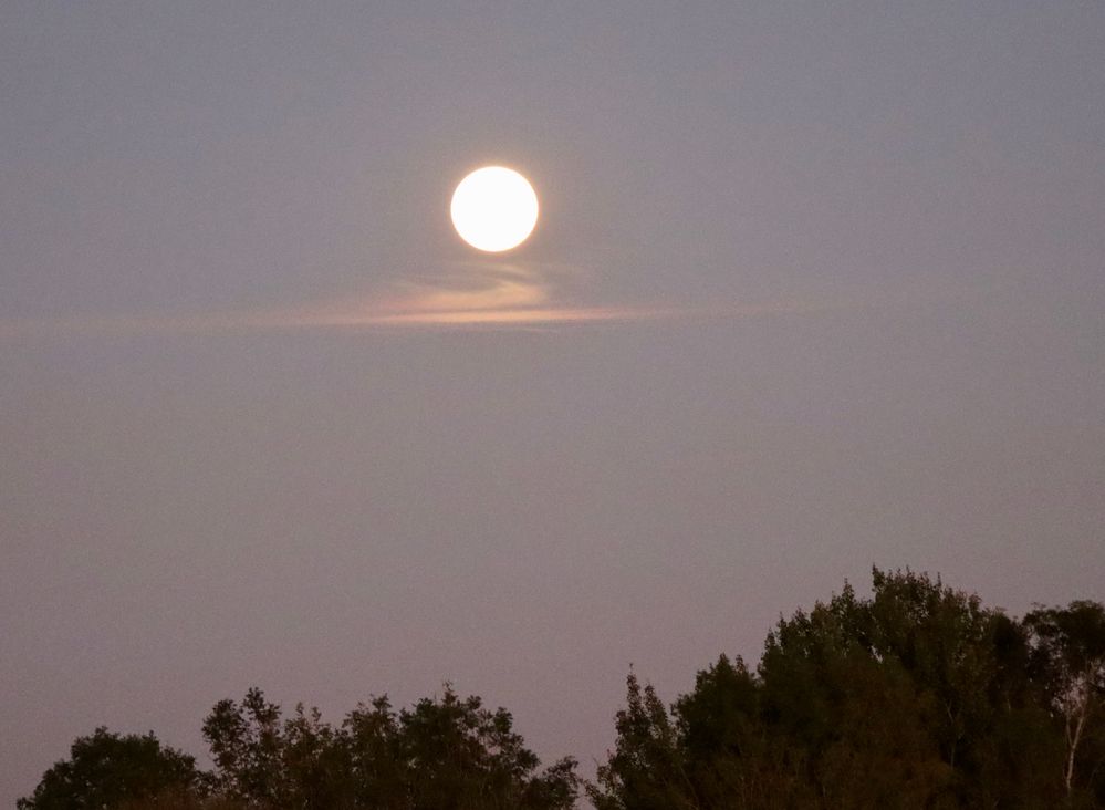

One of the challenges with super long telephotos is the interference of clutter from possible cloud, pollution, dust or even heat has in an urban area or during the summer.  In the following example, I think there was some very, very light cloud up high.
EOS 80D, Sigma 150-600c@600mm, f/6.3, 1/150sec, ISO-320EOS 80D, Sigma 150-600c@600mm, f/6.3, 1/150sec, ISO-320
As to exposure.  I recommend using spot metering centred to isolate the area being read to the actual area of the moon.  To get the right exposure may take several iterations, and is most likely best done in M mode where you control the variables without the camera changing them.  The image above was done using that method to get the details of the moonscape.

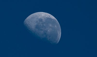

Another option is to photography the moon when there is far less contrast against the sky - essentially as the sun is rising.  This may produce a blue background, which can be interesting in its own right, or modified in post-production to greyscale.
Canon EOS 80D, Sigma 150-600c@600mm, f/.7.1, 1/500sec, ISO-100Canon EOS 80D, Sigma 150-600c@600mm, f/.7.1, 1/500sec, ISO-100
Note that you can get much more texture by shooting when the moon is not full.

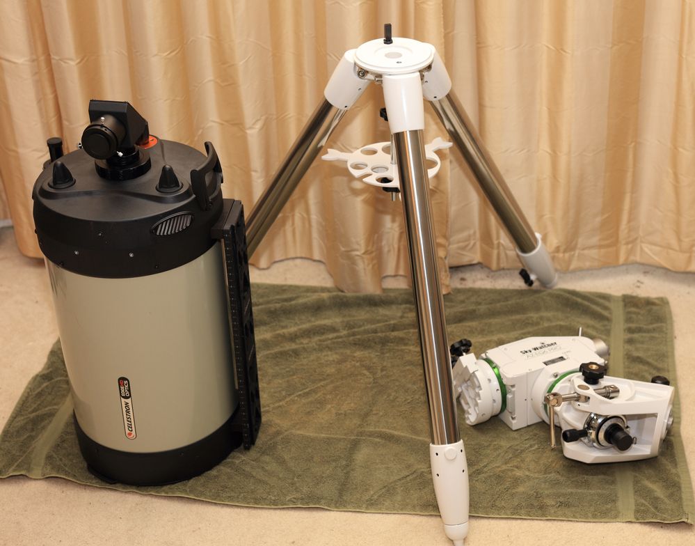

You can "attach" a camera to almost any telescope but what methods are available depends upon the telescope and camera.  The lunar photograph using the Celestron was taken using an adapter that mounts a Canon body directly to the Celestron optical tube and I have an alternate adapter that allows the camera body to be used with the Celestron eyepieces installed for additional magnification.  But a fairly simple alternative that will work with pretty much any telescope is an adapter that allows the camera with lens to "look" through the eyepiece, these are also available for smartphones.

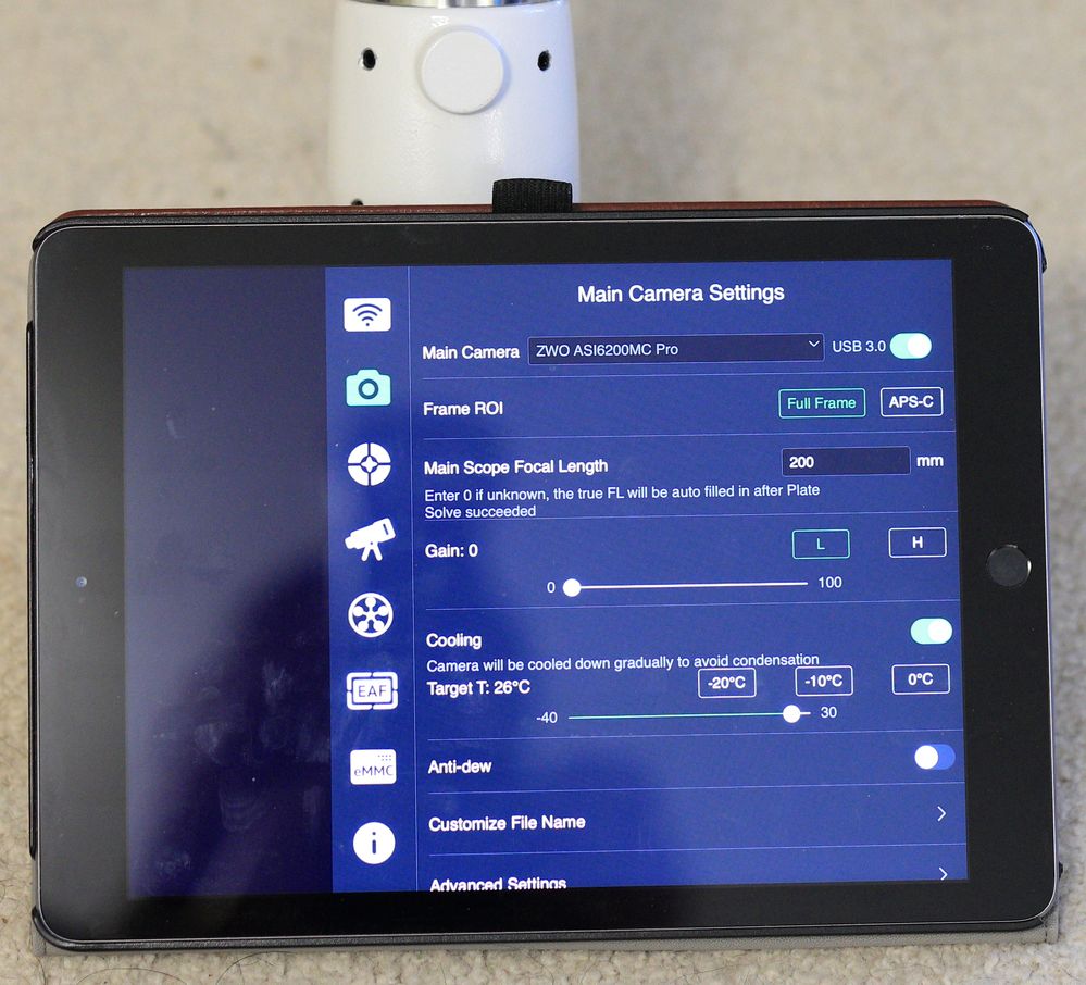

I use a Sky Watcher equatorial mount that can also be used as a simpler azimuth mount when desired.  With the proper hardware it will mount either a large telescope optical tube or a normal camera lens/camera combo and I use a ZWO ASI Air to run the setup via my iPad.  This setup allows the use of a smaller ZWO tracking camera along with the main ZWO astronomy camera which uses a actively cooled Sony sensor and it has an adapter to fit Canon EF mount glass.
