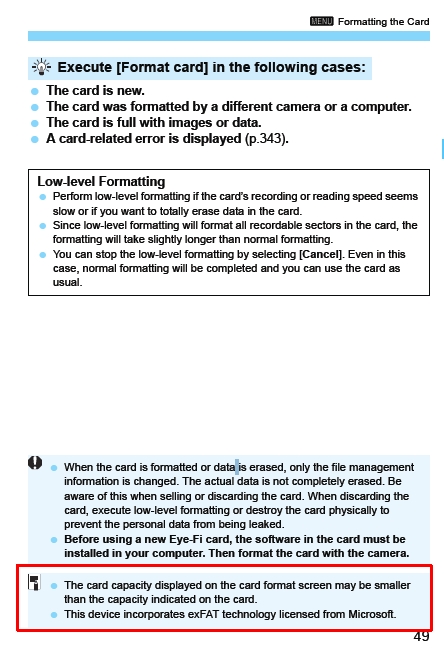

This is what it says in the SL1 manual............

According to Page 46 of the User's manual, your T3i does incorporate exFAT technology. The T2i and T3 also have it.
But..... exFat allows you to use SD cards larger than 128G. It will not let you record video files larger than 4GB because the camera is not set up that way. Even the 5D Mk III and 1Dx can not record video files larger than 4GB.
