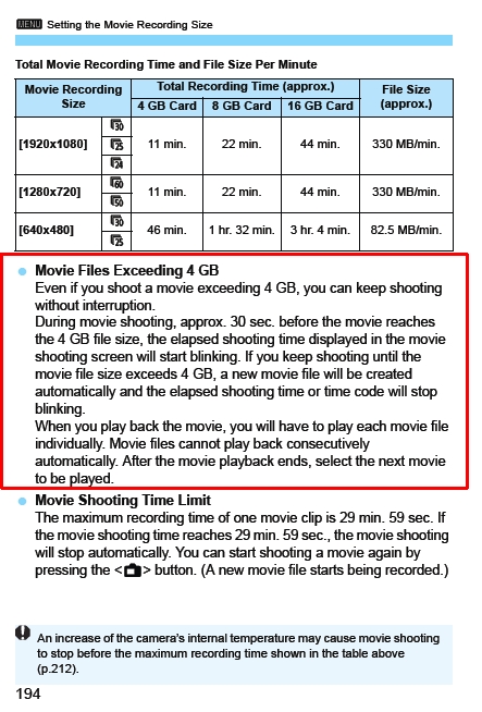

04-06-2014 02:02 PM - edited 04-06-2014 02:15 PM
All of Canon's newest cameras will allow you to keep recording video even if you reach 4GB. They do not "Shutdown".
The SL1, T4i, T5i, 6D, 70D, 5D Mk III, and 1Dx will continue recording but split the video into separate 4GB files.
exFAT is only used with CF cards that are 128GB and larger. The SL1 also uses exFAT so I assume all these newer cameras do as well.

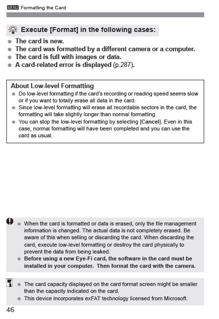

04-12-2014 12:36 PM - edited 04-12-2014 12:48 PM
According to Page 46 of the User's manual, your T3i does incorporate exFAT technology. The T2i and T3 also have it.
But..... exFat allows you to use SD cards larger than 128G. It will not let you record video files larger than 4GB because the camera is not set up that way. Even the 5D Mk III and 1Dx can not record video files larger than 4GB.
