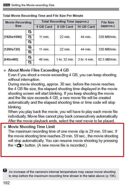

It appears from the table you so kindly provided that 16gb can record for 44 mins (wonder how much it is for 32gb?). However, its says under heading 'Movie Shooting Time limit' is 29 min 59 sec. Which one is it 44 or 30 mins? Anyway, it does not really matter to me as either way this is a massive improvment on 12 mins my t3i provides. This suggests that perhaps I will return my t3i and get myself the t4i.

44 mins is TOTAL recording time for 16GB. 32GB would be 88 mins. Each file would still max out at 4GB or approx 12 mins.
