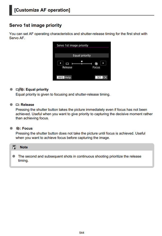

The advanced DSLRs had a setting that doesn’t seem to have been carried over to the MILC R Series. The setting is called SHUTTER PRIORITY. There were seperate settings for One Shot AF and Servo AF. The One Shot setting was carried on, but not the Servo settings.
I always kept the Servo settings set for Focus. This setting makes the camera wait for a focus lock before it fired the shutter. During a burst, you could sometimes hear the shutter slowing down between shots, or speeding back up. My hit rates were over 95%.
I suspect the setting has been removed from the menu, and the firmware setup to always use Focus.
Just the same, I would never use the 40 fps frame rates with a lens designed for use with cameras that topped out at 15 fps, especially with all the other advanced AF features enabled. It’s pretty obvious that’s a recipe for problems.

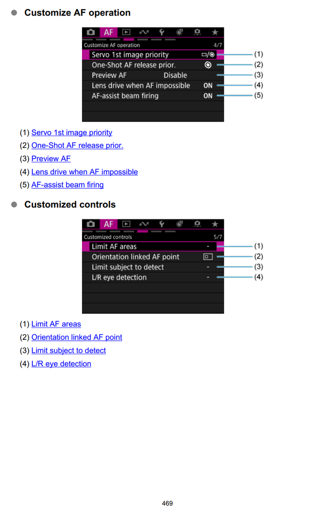

From the R1 manual:

I will also set the image priority to focus and check out what difference I see. Currently my camera is set for equal priority.
