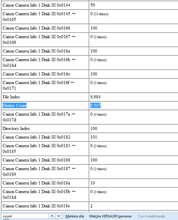

Found today out that 1D III and 1Ds III have a shutter count tag in the image file. Thought 1D II N was the last camera with a shutter count tag in the image file.
Could somebody who owns a 1D III or a 1Ds III try to compare Eoscount vs uploading a raw file at Jeffrey's Exif Viewer?
I uploaded a 1D III raw file and the shutter count was exactly the same as the file number was, so I don´t think it shows correct. The 1Ds III raw file shutter count showed less than the file number. Also strange.

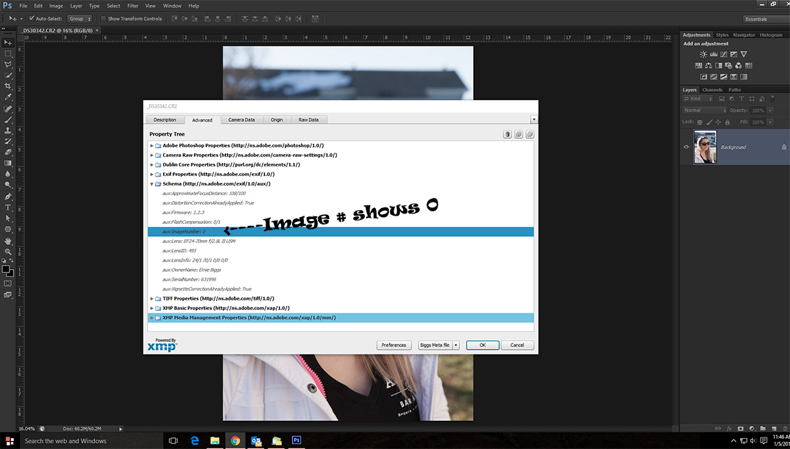

Peter where are you seeing this? It shows 0 on my 1Ds Mk III

Upload a sample at Jeffrey's Exif Viewer and check down there.
I found raw files from http://www.rawsamples.ch/index.php/en/canon and uploaded them at the Exif Viewer.
01-05-2016 01:08 PM - edited 12-25-2016 09:32 AM
But what number am I comparing it to?

01-05-2016 01:15 PM
OK. I remember that but you said, "Found today out that 1D III and 1Ds III have a shutter count tag in the image file"
I don't think this is true?
01-05-2016 01:31 PM - edited 01-05-2016 01:32 PM
I also think it isn´t correct, but the Exif viewer shows the shutter count tags for EOS 1D, 1DII, 1DII N, 1Ds, 1DsII and 1Ds III. No other camera from Canon. I heard Canon 1D II N was the last camera from Canon with a shutter count in the image file, but the same shutter count tag shows up in the viewer with 1D III and 1Ds III.
