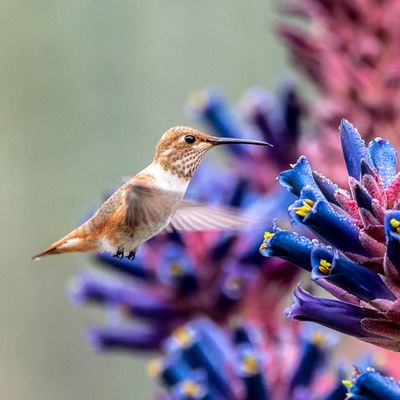

My method is to use a wide aperture (fast shutter speed), a long lens, auto focus set with a single focus point located in the center of the frame, and hope for a sunny day. I also use a monopod for stability. I enjoy taking hummingbird photos in a garden setting as they frequent their favorite flowers. Usually I try to catch some blur in the wings to suggest movement, but posted below is an example with the wings completely frozen. With a 600mm lens I can usually stand motionless about 15-20 feet away from a popular flowering bush, the long lens makes a hovering hummingbird appear large in the frame and the AF has no trouble locking onto the moving bird. You can see more examples of my hummingbird photos at my Intagram @CaliforniaViewFinder. The hummingbirds don't always cooperate, but I use the same set up to take whatever birds I can find and very often that includes hummingbirds. I've recently swited to a Canon R5 Mark II but the example photots are taken with an older Nikon D750 with 100-600 mm lens.

I like that the Salvia flower can be seen through the wing. Nice capture.
10-16-2024 06:25 AM
Great shot! Love it. Seeing the flower through the wing is fabulous. My compliments! It's great that the hummingbird lined up in the plane of focus. That's one reason I usually don't shoot with wide-open aperture - bokeh is great for blurring out the background but I don't like it for blurring out the subject of the image, in this case, the entire bird. But, luck being luck, if it lines up, as with this, it works, giving you a fast shutter and lower ISO. The other way, if you get it, it's a higher ISO, resulting in less cropping ability. Thanks for sharing this terrific photo!

Glad you liked the pic. Here’s another using the same method but a slightly slower shutter speed, leaving some blur in the wings. The depth of field is about 3 in which in this case is enough to capture the near bunch of flowers but blur the flowers in the background.

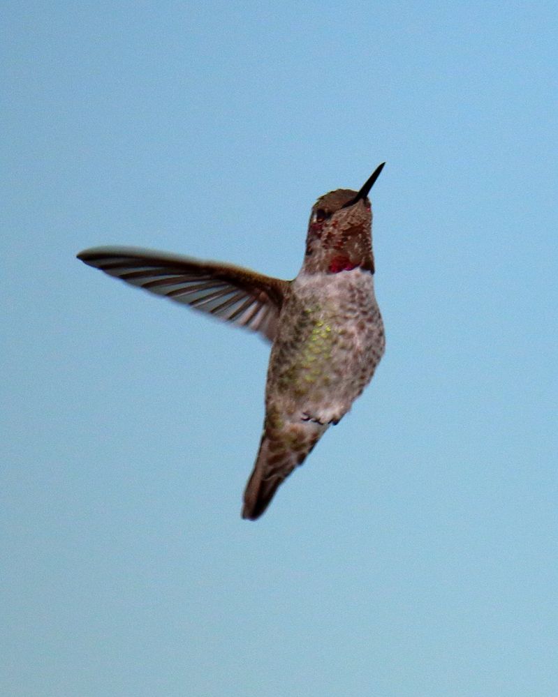

11-24-2024 03:01 PM - edited 11-24-2024 07:57 PM
A couple of Anna's Hummingbirds are showing up again in the backyard. It's challenging to get them in flight and in focus.
