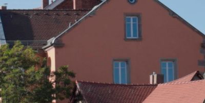

hey guys,
i love my r6mark ii but in some situations i see red noise, randomly, at certain areas of the image when shooting video (not in photo mode). I am shooting in clog3 always iso800, sometimes lower. no filter attached, no picture style, no baked in lut. Only in Editing I apply the Canon Clog3toBt709dWideDR Lut. In this screen grabs it seems not that distracting, but playing it you see it very much. I dont think it‘s a sensor problem, i think it might come from ibp compression. Because it is not always on the same place. Does anyone else experienced this? Of course you have to crop in to see it, but on a big monitor you can see it without cropping in. I also shoot with other cameras but never experienced this.
*shot with Canon RF 35mm f1.8 Lens

i see it only in video, i shoot on a rf 35mm f1.8 stm and i shot in clog3 and applied the canon cinemaeosclog3tobt70dwidedr lut in davinci. No filter attached. No picture style, no creative mode.
it is shot in Germany, Bavaria 🙂
