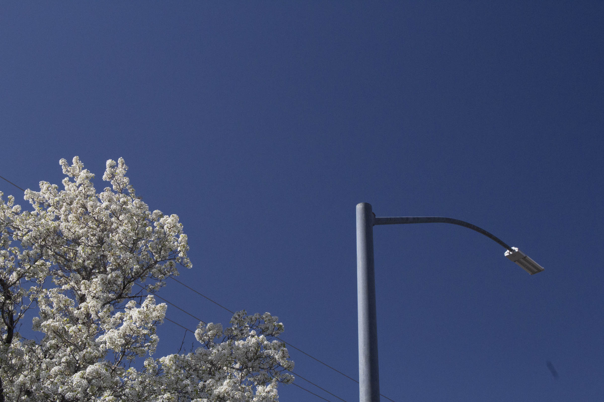

I recently got my rebel for Christmas and have been using it in a basic 101 class. My teacher and I have noticed that in my photos with low ISO, there is as much noise as with and ISO 1600. The lens and everything has been cleaned, I've done bracketing shots and all are the same, I'm not sure if it's an internal issue or not. Anyone having similar issue or can offer advice

Here are some examples.
 The first photo is ISO 100 and the second is ISO 1600.
These were shot with my 18-55mm zoom stock lens that came with the camera kit. At first I thought the issue was just this lens but it has happened with my brand new 50mm as well.
File size is too small to see anything meaningful. Can you upload full size images?
took camera in today to get it looked at an there is nothing wrong with the sensor or the lens but they think it could potentially be the chip. Please let me know what you think
There is definitely something in the sky. Are you sure someone didn't try to clean the sensor with liquid cleaner? It looks like there is something on the AA filter. Its not digital noise.

The res is so low I can't say but I really don't think anything is wrong. I d/l the two images and really don't see what you are.
