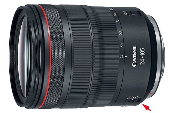

I have a canon R6 that is stuck in manual focus mode when using the Canon RF 24-105 lens. I tried a different lens and Auto focus is back but when I put the 24-105 lens on I loose auto focus abilities. I have gone through the menus, manual, and every button I can find but nothing will allow this lens to go back to auto focus. Any help would be appreciated.

I apologize but I have to ask, have you cycled the AF/M switch on the lens?

08-09-2024 09:53 AM
I did look but this lens does not have the AF/MF switch. It only has the Focus/Control (which I tried in both settings) and a Stabilizer On/Off. I know the lens has auto focus capabilities, I've been using it since I got the camera.
The other lens that does work has the AF/MF switch.
Makes me think there is an in camera option that isn't working or I'm not seeing somehow
