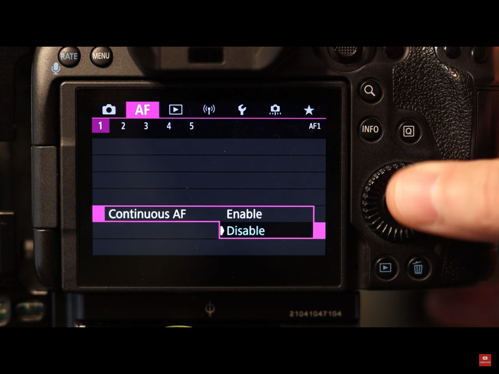

The AF system in Canon’s M and R series bodies works a little differently from DSLRs when it comes to Servo AF. Canon has not only dropped the “AI” in “AI Servo AF”, but it can run continuously regardless of whether or not your finger is pressing the shutter or another button that activates [AF-ON[.
The setting is probably great if you are using a tripod, and your subject is continuously in the frame of the lens. But, probably not so great if you are shooting handheld, and move the camera off of the subject periodically. The factory default setting is enabled.
