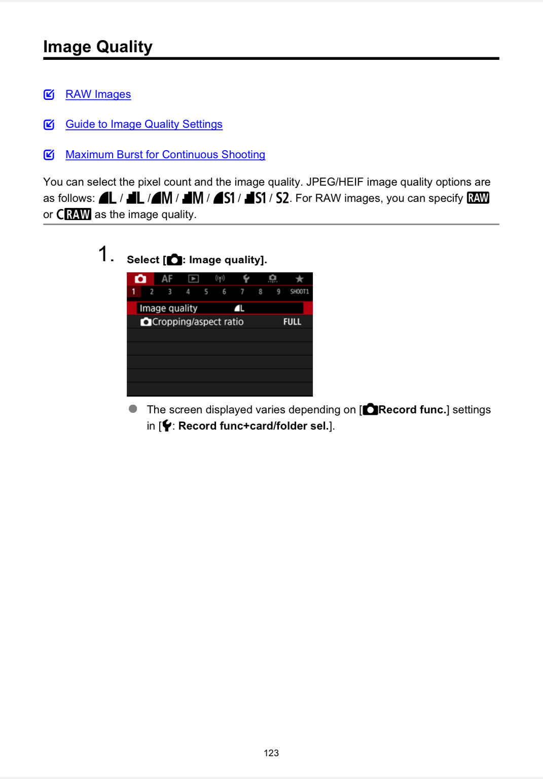

So I can't get my R6 to write to both cards... it will allow me to switch between card 1 and 2 or write photos to one and video to the other. I went in the settings and set it how I would normally on my mark iv  and it's only writing to the one card. I pull it up with the Q and use the touch screen, wont let me select both. Can't find the answer in the manual or on youtube. What am I missing?..feeling very new right now...

Waddizzle
Canon's menu system is really odd when it comes to setting up writing to two memory cards.  Instead of setting it up in one spot, you have to go to two places  Image quality for each slot, and then you actually setup writing to either or both slots..
Yeah, thats where I am going,.. it's not giving me options for seprate cards at the same time. I even tried making a new folder. I will let me shoot card 1 which puts it in "100canon" or 2 which puts it in "101canon"
It is weird the way Canon has it set up, You have to go to two different menus.  I like to add them to a custom menu, so that they are in one spot, one right after the other.  Here is the next page from the above screen shot.
I think you are halfway there.  You have told the camera what format to save to each slot.  Here is the next menu you have to rind.  You have to tell the camera which slot to actually use.
FloridaDrafter
So far, my wife has been using just one card, so I haven't looked at what gets writen to card two. Anyway, I just put a card in slot two and get the menues shown on page 693 of the latest manual (1.3.0 or Later), see attached. They look similar to my 5D mark IV, so I guess they work the same. Once you select "Record func+card/folder sel." you will see Record options for either still or video (Standard is default). Once you select the still option, you will see what you do in the 5D4.

Wow, I don't know why that was such a struggle from me.. my brain was really not computing.. I really appreciate the walk through! Thank you so much!
