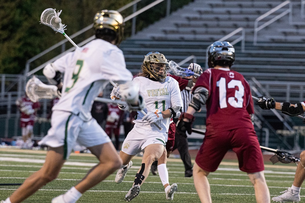

At night, under the lights, I'm still using TV mode and allow the aperature to be wide open and the ISO roams up to 25,600.
In the photo below, #11 had been running the lenght of the field.  As so often happens at the crucial moment, the athlete is in heavy traffic, but for just this once, the camera stayed with him.

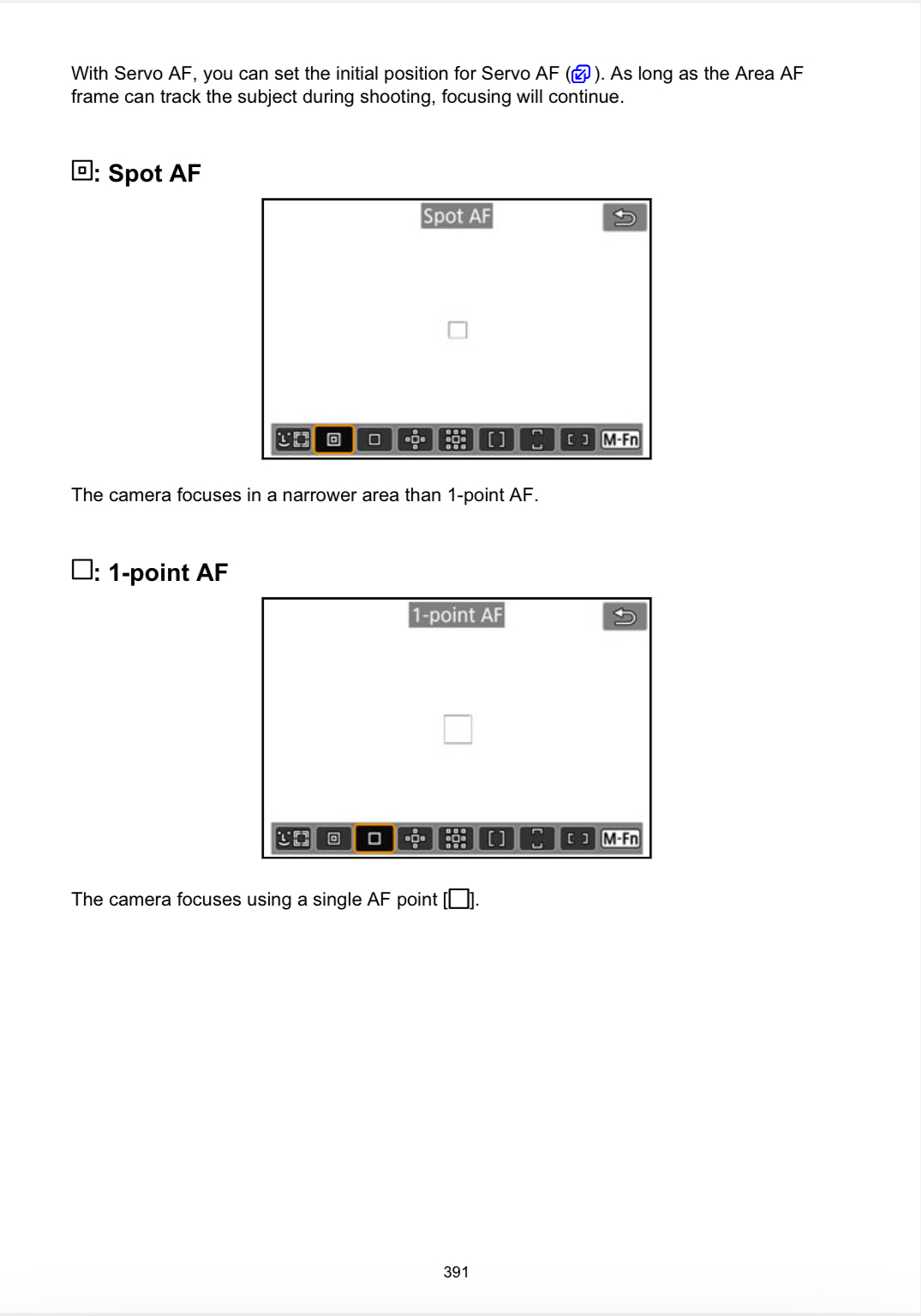

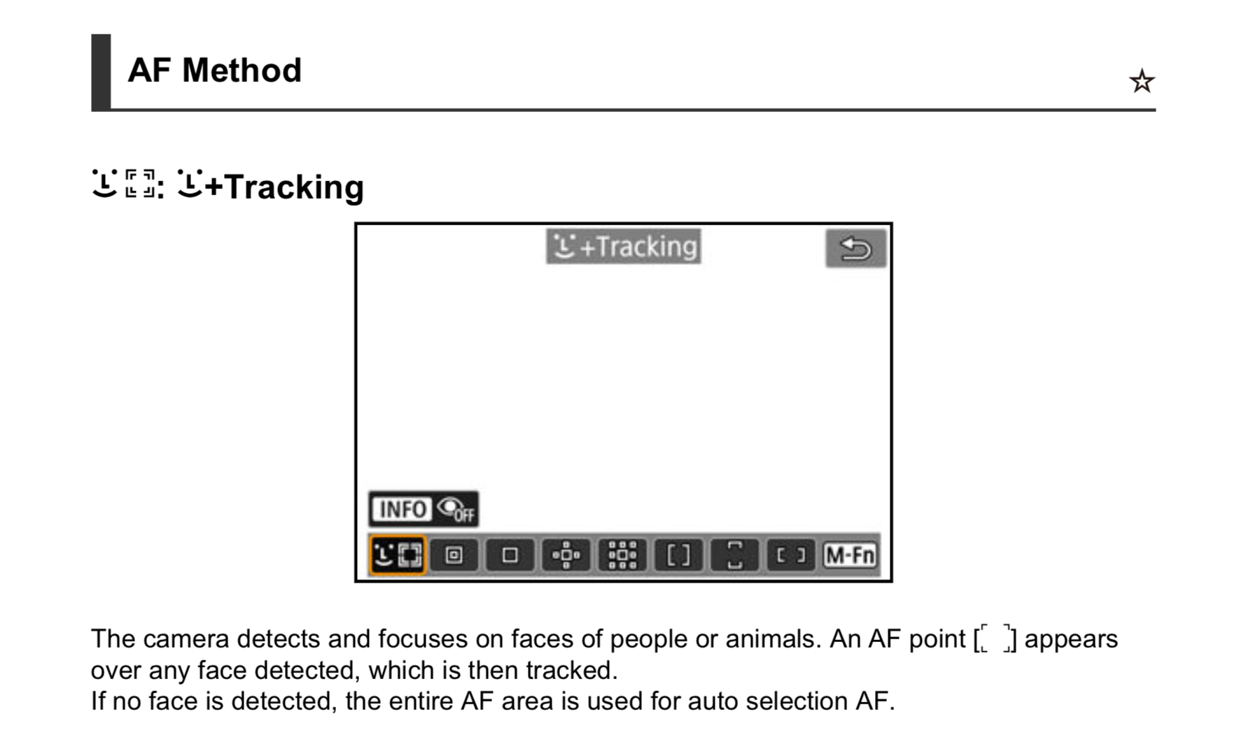

You still don't seem to understand. When you use only a single AF point, the camera cannot track anything.  All that it can do is focus.  The camera cannot recognize faces using a single AF point.  You must use one of the Zone AF modes for any tracking mode in the camera to engage.
With these settings the responsibility of tracking a subject falls onto you, the photographer.
Focus points are an illusion on the EOS R5. In fact the camera is always tracking things no matter what AF method is selected.
@shawnphoto wrote:
I am not talking about focus tracking.  I am talking about facial recognition and tracking the subject's movement around the frame.
[EDIT]. If the camera tracks movement around the frame when AF Method is 1-Point AF, then I will stand corrected.
