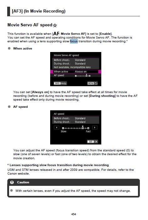

The manual states that there is a video servo focusing speed setting in the menus. See page 454:
