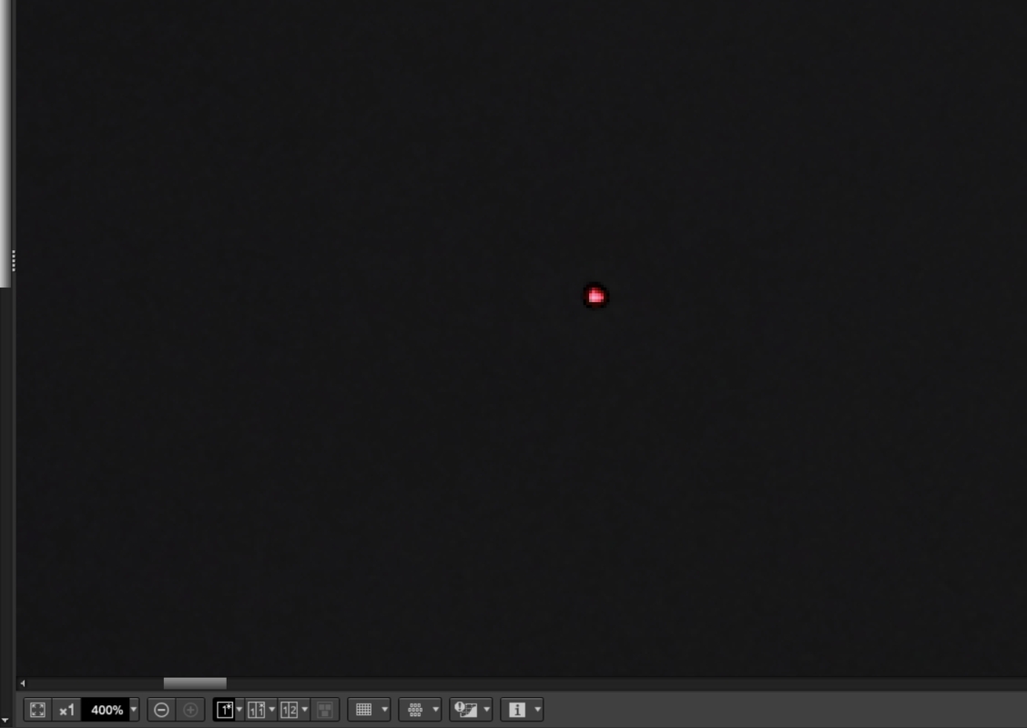

I have 5 throughout the frame and all are red and in the same spots. I have never had them on any of our DSLR's. I have a basic understanding of what causes them, but have never seen them before.
Mine don't seem to be from high ISO or long exposures as they appear in all of my shots, from ISO 100 to ISO 3000. Now, they are less noticeable at ISO above 4000. I'm assuming that the camera is adjusting them out with high ISO noise reduction, but that is just a guess. When converting to JPG, they almost disappear, but I understand why... It's just the nature of lossy compression.
Anyway, any need to be concerned?
Full frame converted to JPG in DPP 4. ISO 1000, SS 0.3, f/2.8, EF 24mm f/2.8 lens, R5, hand held. I posted this just as an example. But the red pixels are in all of my shots, they are just more obvious in this example.
50% zoom in DPP 4 (Screenshot).
400% zoom in DPP 4 (Screenshot).

Boy was I wrong! I did it by just initiating "Clean Now" 4 times. I took about 50 test shots with varying ISO settings (100-6400) and all five hotties are gone.
Maybe Canon has included pixel mapping in that routine, I just don't know, but for now, my red pixels are gone.
