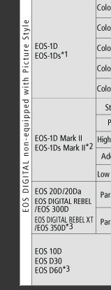

Mmm how would I apply them to cameras which don't have the feature?
The table explicitly refers to newer cameras and how to achieve the older look:
If you want to produce colors approximating those of earlier EOS DIGITAL cameras, use the table below to select the right Picture Style.

@Chube wrote:Mmm how would I apply them to cameras which don't have the feature?
So far as I can guess, your 60D was not that old. Using the "Standard" picture style in a newer camera is likely to match the standard picture style in the 60D. Those very old cameras did not have the picture style feature.

Those earlier EOS cameras did not have picture styles.
Read the text on the side of the chart:
To get the same effect in newer cameras you use the same picture style.

Yes that's the point, you use the new picture style on new cameras to get the same look you had in the old ones.
And they tell you how to do it: set to standard, lower contrast.. and so on

I don't think you are rading the table correctly;
1st column is "older cameras with no picture style" (from 1d to 60d)
from 3rd column -> : settings you need to achieve the look of the camera in column 1 with a new camera.
It seems pretty straightforward

The first column doesn't mention the EOS 60D. It mentions the D60. Those are 2 different cameras. The EOS D60 came out in 2002. The EOS 60D came out in 2010.
The 60D supports the following PictureStyles natively:
The EOS D60 does NOT support ANY Picture Styles in-camera (natively), therefore you would have to apply the Picture Styles in software DPP to achieve the vibrant look. This is for the much older EOS D60, NOT the EOS 60D.
