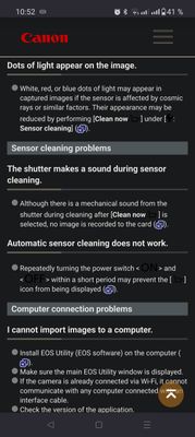

 Use the sensor cleaning method if you have hot pixels also at short shutter speeds.

I know how to remove them using software tools or just by enabling Long Exposure Noise Reduction in camera.
My main question is - does the amount of seen broken pixels in my photos are ''Normal' or are there too much of them so I need to service my camera. Sensor cleaning feature does nothing to minimize those broken pixels for me.

Removing hot pixels.  Its possible some can be removed by re-mapping, but I would not count on a night and day difference.  You can check with support to see if this is possible on the R6 and what result you might expect.  I believe the improvement could be fairly limited.  @Peter and @Waddizzle's advice would probably help the most.
