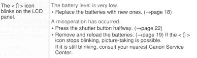

Just bought this camera and cannot for the life of me figure out why it's not taking shots, sometimes. It does take photos sometimes and advances the film, but most of the time, when I press the shutter button, you can hear the sound of the shutter, but it doesn't take a photo. It almost sounds like it opens the shutter and stays there. If you press the shutter button again, it closes. O basically it sounds like it's in "bulb" shutter speed, but it's not. The film does not advance either when that happens. When this happens the battery sign flashes on the little display screen as if it's low, but I have brand new batteries. TIA!

I doubt it is mirror lock up. It isn't lens sensitive either. You might try a new battery and charger. A weak under charged battery can cause that.
Otherwise, I am afraid it is broken and not a good candidate for repair. Find another one if you still want to use one.
