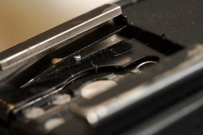

There is a small microswitch sensor under the hot shoe rails which senses when a flash is attached. It is there to prevent the built-in flash from popping up when an external flash is attached. It must be sticking or malfunctioning.
You could try try cleaning the Hotshoe rails.
