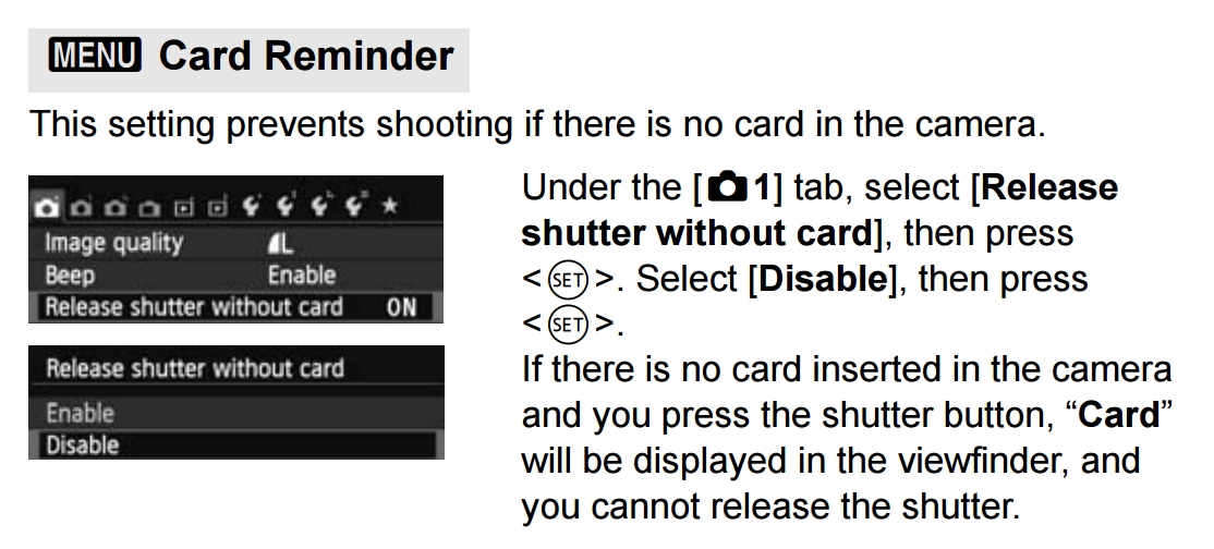

That's a very unusual situation. The only thing I can think of was that the SD card wasn't fully inserted. Can't help you now, but, to maybe prevent it from happening in the future, go into the menu and change 'Shoot without card' to No.

Ttmartin: yeah, we seem to get the weird problems. I doubt the card was loose. the mechanism that clicks and locks it in seems to be in good working order. Couldn't find the "shoot with no card" option in menu. Thanks for your response
Page 200 of the T4i Manual
