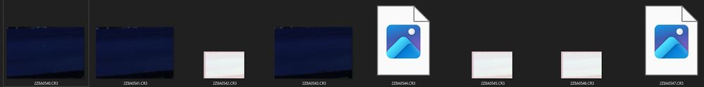

Odd blocking and discoloration around Pictures when viewed on computer from R5 Mark ii when view on the computer. I never had this problem when I loaded to my computer with the M50 so I am unsure why this is doing this but it makes it hard to choose pictures to edit. It does not show when I go into Lr or in the Canon program but I don't want to load hundreds of pictures into Lr and the Canon program makes no sense to me and I can't find a selection to move pictures to Lr that I like. I have included some pictures. Also some pictures are not showing up full sized on the computer. Thank you for any help given.OddColors.jpg

The blocks are masked pixels and almost all raw files from Canon have masked pixels. Raw files from 1Ds don't.
Your M50 for example has 264 columns of masked pixels to the left.

Your image viewer doesn't know how to read the raw file, but DPP and Lightroom know.
To make it simple a raw converter needs to set the black and white level, crop the image, set the white balance, remove hot pixels, reconstruct clipped highlights if not all channels are clipped and prevent the highlights from turning magenta, demosaic the Bayer pattern, add a color matrix. After those steps the raw file is ready to be edited by you.
The picture you shared is clearly lacking the cropping part and the black/white level. It is demosaiced and I think that the white balance is turned on.
More about black level here https://www.dpreview.com/forums/thread/4767326
Masked pixels are also called optical black.
You haven't shared any raw files, but I guess that the files are fine and that the issue is your image viewer. If you convert a CR3 file to DNG, does it look normal?

Is it Microsoft image viewer you are using? In that case you will have to wait until someone updates it. If the file viewer is using a library from Libraw it may take a year. Use something else meanwhile.
To share raw files you just use a filehost, like Google Drive, WeTransfer.
