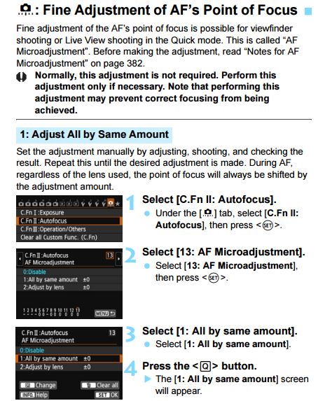

The only thing Samy's Camera can do is to do a micro-adjustment procedure for you...only Canon can do more. This auto focus micro adjustment (AFMA) is something you can do yourself.
AFMA does not affect the camera noise level so that is weird. Do you have the same noise at all settings (Av, Tv and especially ISO)? Normally if you set to a higher ISO, you get more noise...it is possible you tried shooting at night after you get it back and in auto mode, ISO is high and therefore more noise...that is simply the way any camera works...
The best for you is to bring it back to Samy's to at least find out what they did to your camera and lenses. If it's just AFMA, you can go to the menu and disable AFMA or set everything back to zeros.
