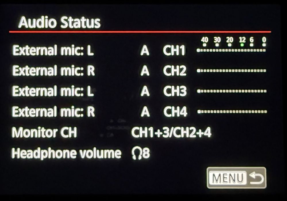

Are you sure this is the case? I can't manage to combine the internal stereo mics with the 3.5mm input. If I plug in an external microphone, the camera simply mirrors those two tracks to channels 3 and 4 when recording in 4 channels (which is just useless waste of storage). I can't find a way to enable the internal mic as long as an external one is connected via the 3.5mm input.
As far as I can tell, the only way to actually get 4 channel audio is by combining a hot shoe accessory for audio and either the internal and an external mic. And the only two devices I've found to support the hot shoe are the Canon DM-E1D which costs about half as much as the body itself or the Tascam XLR adapter which costs about as much as the body itself.

Hi Rick, thanks for the response. 4 channel LPCM is selected, but no matter what I do I can only get internal mic on channel 1 through 4 or external mic on 1 through 4. Channels 1 and 3 and 2 and 4 always contain the exact same audio. I don't see any way to change the sources for either channel and the manual also does not explain how this could be configured.

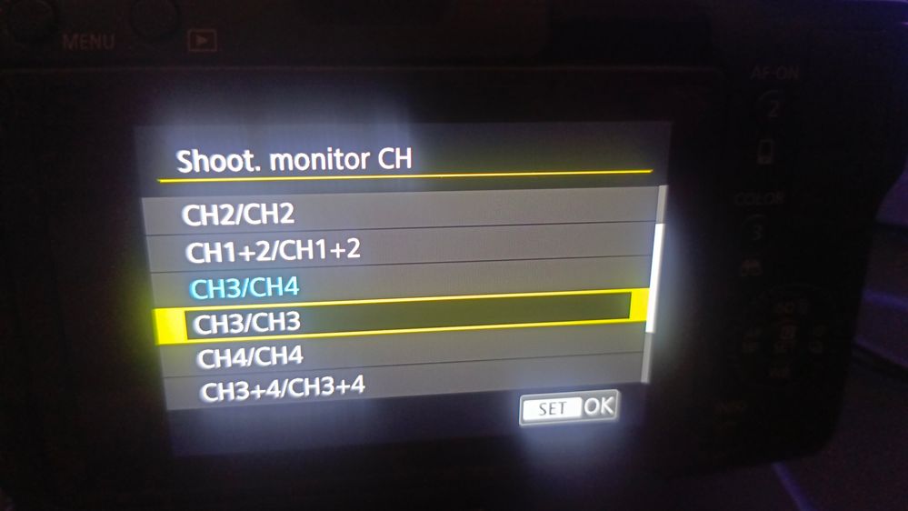

4-channel recording. Monitoring 3-4 channels.

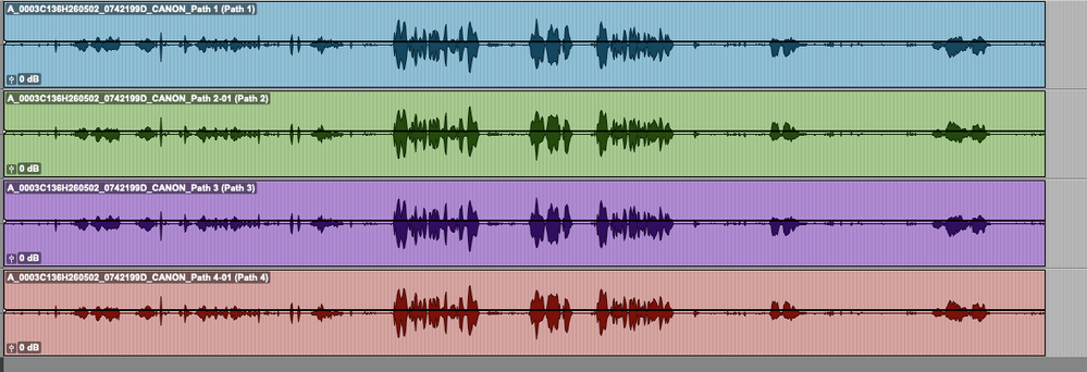

Result: 4 identical files. 2-4 are out of phase.

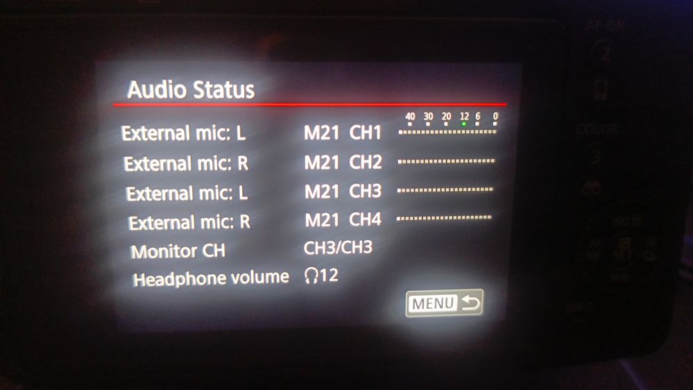

I connected a Zoom F3, a Sony stereo microphone, and a lavalier radio.
If I don't connect anything in 4-channel mode, it also records 4 identical files.
I think it's a firmware bug. What do you think, Canon?
It can't record 2=2 independent stereo channels.
This is visible on the camera's screen. It switches the names of all four inputs to EXT and INT.
