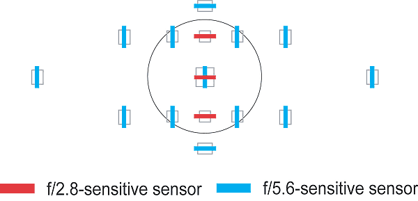

See the AF point pattern in the above response? Note the 6 points right around the center one (roughly on or within the circle denoting the spot focus area), making for a total of 15? Those are "hidden" Assist Points that have to be enabled in the menu, are not indicated in the viewfinder and only work in AI Servo focus mode. The other nine points (center one, plus 8 peripheral), as seen indicated in the viewfinder, are available in both One Shot and AI Servo. For the type of photography you are doing, I'd be using One Shot, which gives greater accuracy than AI Servo. (Notes: 1. Above ignores AI Focus mode... because it really isn't a focus mode at all. In AI Focus the camera is supposed to decide for you whether or not the subject is moving, then switch to using the appropriate mode: AI Servo for moving and One Shot for stationary subjects. 2. Live View focusing uses contrast detection AF instead of phase detection that's done with the AF points seen in the viewfinder, is even more accurate than One Shot, although it's much slower.)
Of the nine "usual" AF points, on 5DII (and 5D original for that matter), yes, only the center one is the more sensitive "cross" type. All the others are single axis an less sensitive. However, for the types of things you shoot, they should all be usable. The 5DII's AF system is rated down to about -.5 or -1.0 EV light levels, if memory serves. I find the center point on mine is actually a little better in low light than my 7Ds or, before them, 50Ds... all of which are rated the same as the 5DII. Slower, yes, but still able to lock on after the 7Ds and 50Ds gave up completely.
Anyway, I most often use the center point only on my 5DII (and with other cameras). You do have to be a bit careful focusing and recomposing, though, with any shallow depth of field shots.

The EOS 5D Mark II has two types of focus systems. Phase-detection AF is active when using the viewfinder and Quick AF mode in Live View. Contrast detection AF is available in Live AF and Face Detection Live AF modes in Live View. Generally speaking, contrast detection will focus where the issue is "camera will not focus". If you were able to adjust to using Live View at least some of the time, I think you could increase the number of keepers you get.
In order for the center point to function as a cross point, it needs an aperature value of f/2.8 or greater (f/2, f/1.8, etc.). Your 17-40mm lens is not fast enough to enable cross point functionality.
