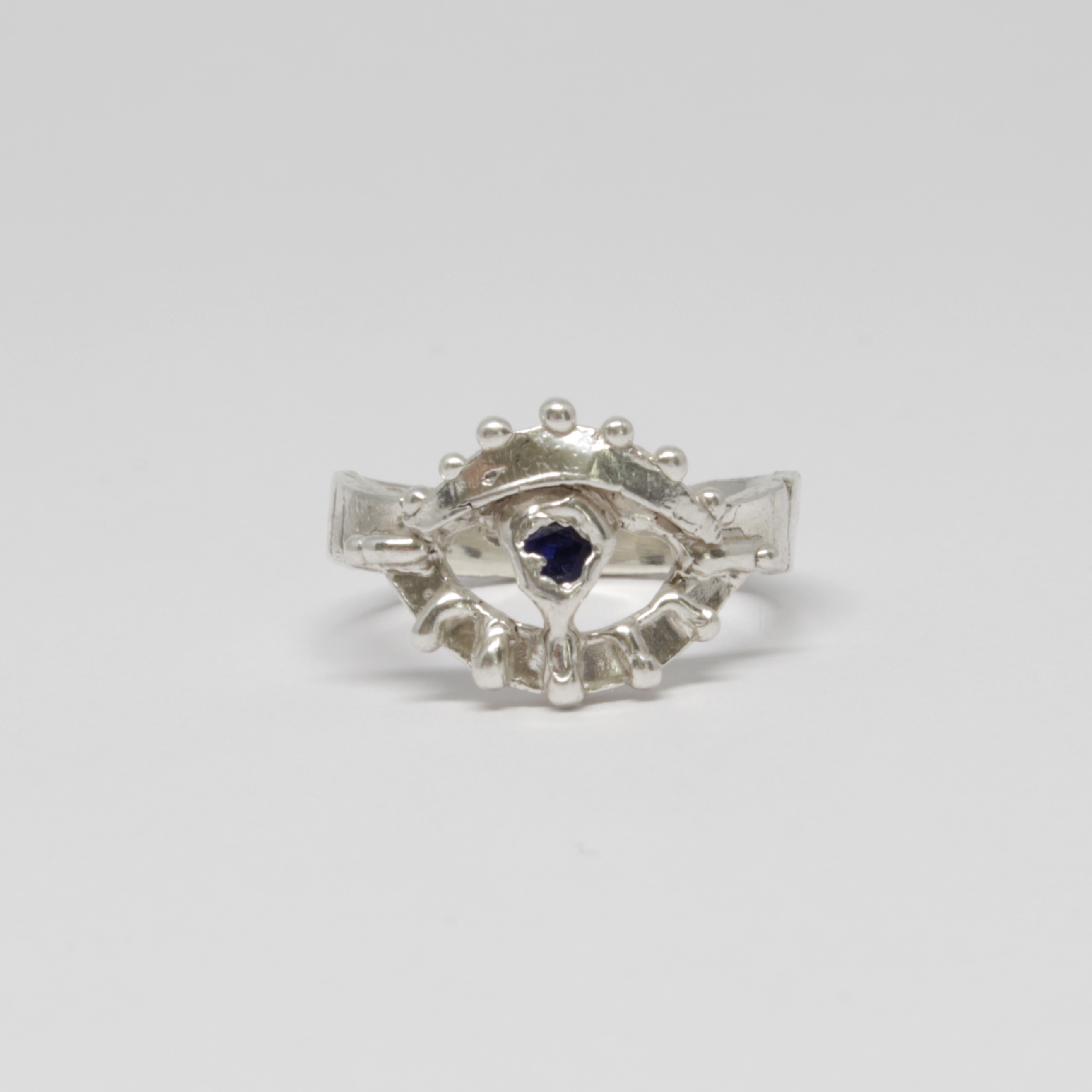

Update 2
Thank you everyone for the suggestions. I read an article about the exposure triangle and found it very helpful. http://learn.usa.canon.com/resources/articles/2015/understanding-exposure-triangle.shtml
The tripod has helped. I shot this in manual mode and its already substainially better than the previous photo. With some editing in photoshop I think the end result will be pretty good. I came here to get advice on getting the entire piece in focus and you were all able to help me with some suggestions for that! I recognize there are many other areas I can address to over all improve my photography. I will continue to read, experiment and take pictures. I also realize the colorpicker **bleep** is something I will need to educate myself about thoroughly.
Thanks everyone!
06-10-2016 08:10 PM
"The tripod has helped. I shot this in manual mode and its already substainially better than the previous photo. With some editing in photoshop I think the end result will be pretty good. "
NICE WORK. Very nice! It looks like work done by a completely different photographer.
What version of Photoshop? The full blown version [not Photoshop Elements] can do the focus stacking that I mentioned earlier.
