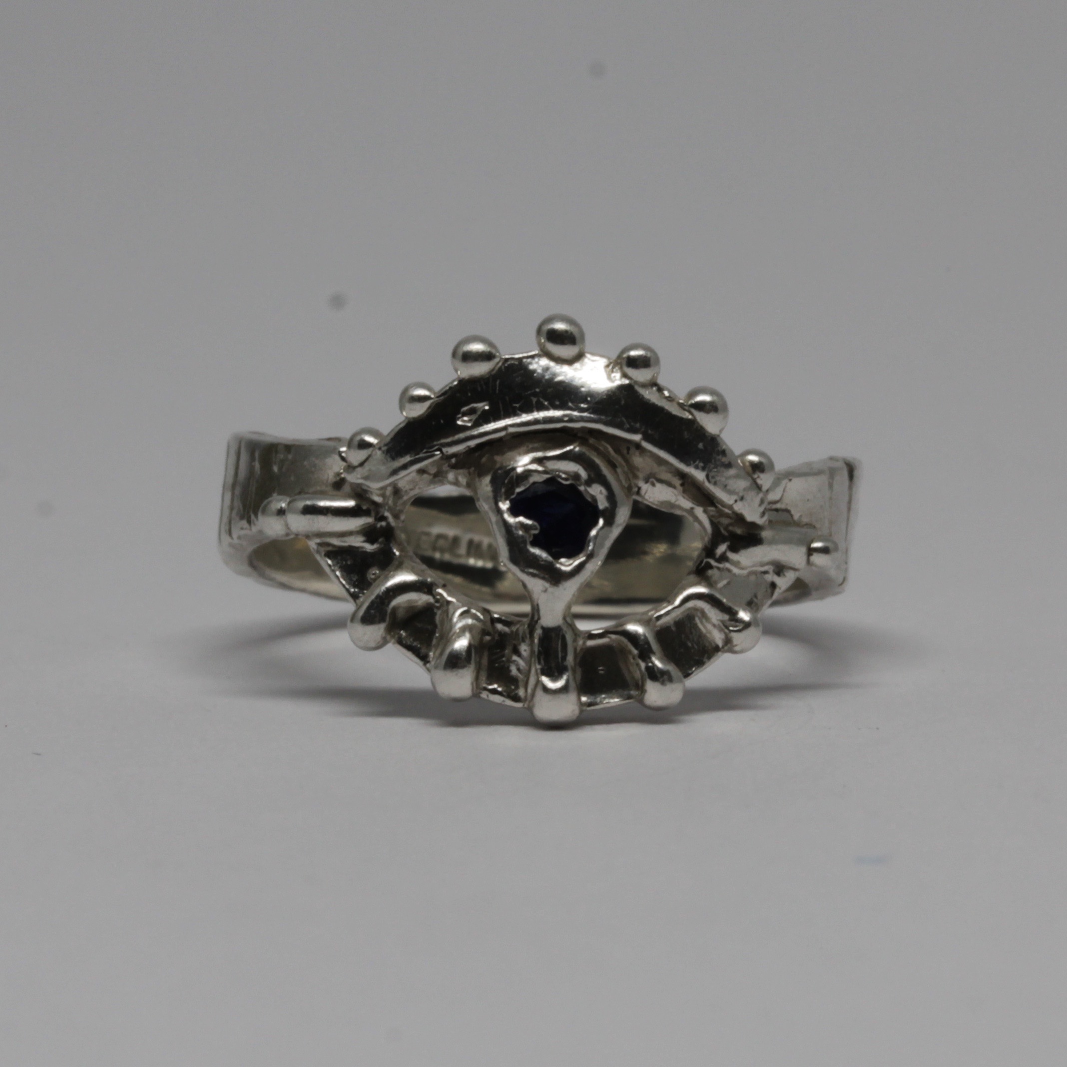

So now that I have the tripod I attempted to shoot in AV mode with my macro lens. This is f16, iso 100 and I could not figure out how to change the exposure from 0. The dial near the view finder didn't change it nor was i able to pick it in the digital display while in AV mode. It is way, way too dark.
I completely agree about using software to edit. I have photoshop and lightroom. I even purchased a colorchecker **bleep** which I am struggling to use. I feel way in over my head.
I really need simple, begininer advice. My understandling of photoshop is a begininers understanding. The reason I initially posted was because I need the entire jewelry in focus before I can cut it out and paste it onto a pure white background in photoshop which is what most jewelry companies do. Then I went to the camera shop and they sold me on the colorchecker **bleep** because I would love to be able to get an image that just looks great and doesn't require being cut out. I literally spent 6 hours today trying to figure it out and because i'm also new to lightroom I was having a hard time.
But I digress, white balance aside I am still having a hard time getting everything in focus. I also tried f32 iso 100 for a 0"6 exposure and the photo looks the same as this.

Hopefully, the tripod will work out for you.  I have grave reservations and doubts about it.  The head isn't interdhangeable.  Be careful of extending the center column, as that greatly increases the instability of a tripod.  Use the weight hook on the bottom of the center column to stabilize it with a weighted bag.  It is rated at just over 10 pounds, which doesn't mean much.
You cannot change the exposure in Av mode because in that mode the camera sets the exposure.  Make a note of what shutter speed the camera decides to use, and then switch to "M", Manual, mode and use the same exposure...or adjust it if you wish.
You can stack images in Photoshop CC and CS6 by using the "Auto Blend Layers" command.  Instructions on how to do it can be found in the online Help.  Try typing "focus stacking" into the search box of the Help screen.
You may want to rethink on your lighting.  I think you need more than one source, brighter sources, and possibly diffusers.  You want it to be lit up as bright as daylight.
Don't look for shortcuts.  There is no substitute for careful, meticulous work.

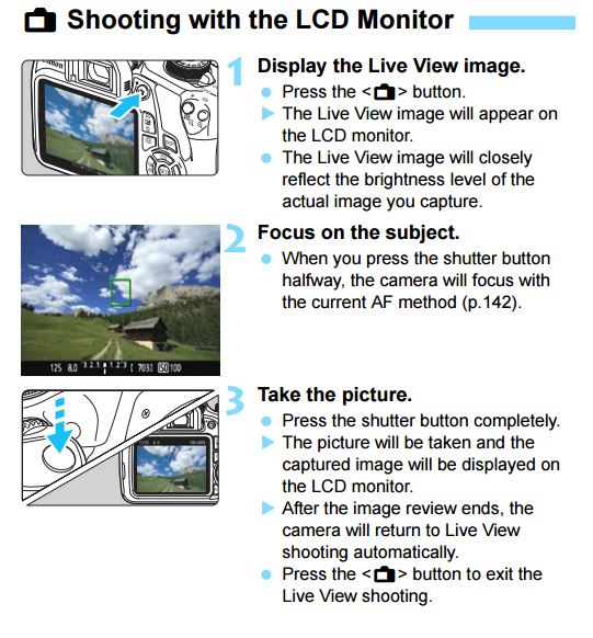

Since you are fixing the aperture to f/16 and the ISO to 100, the only thing you can change is the time.  Therefore you should use either Tv or M and not Av.  In Tv or M mode just change the time value (Tv) to something that would proper expose.  In your picture, looks like it might need to be around 1.5 seconds or so.  Properly exposed, I think your background will look white.  In light room you can use the dropper, click on the background and it will adjust the color to white for you.
For this kind of shooting, it is best to use live view so you can see exactly what the picture will look like  exposure-wise...it won't show you the depth of field, unfortunately.  Here is how to get to live view.
In Av and Tv mode, you can also use exposure compensation to change the way the picture look (i.e. brighten it).  The dial next to the viewfinder is not the one to use.  Here is an excerpt from your manual

I must tell you to read up more on how to use your camera before you can get the kind of professional looking pictures that you desire.

Ernie said that great pictures are made in post.   He's right.  It took more clicks to load the image, than it did to edit.
I brightened up your photo by 1 stop, did a click white balance on the background.
BTW, those spots are a dirty sensor.  You need a BLOWER to clean it off.  Get a professional to do it for you at this point.

Yes a Rocket blower bulb or a knockoff of the same.
You you can also use the "clone" function in Lightroom to make a little spot disappear in about 2 seconds in the develop module.  You do want to get the dust off the sensor though, so you don't have to do the same spots over and over again in every shot.
