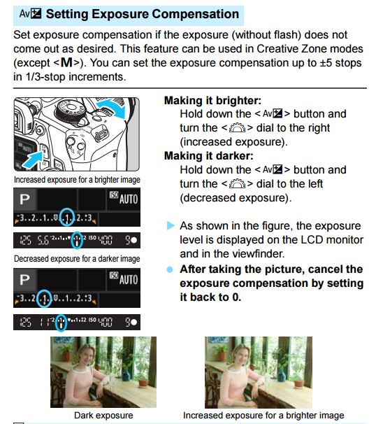

In Av and Tv mode, you can also use exposure compensation to change the way the picture look (i.e. brighten it).  The dial next to the viewfinder is not the one to use.  Here is an excerpt from your manual
