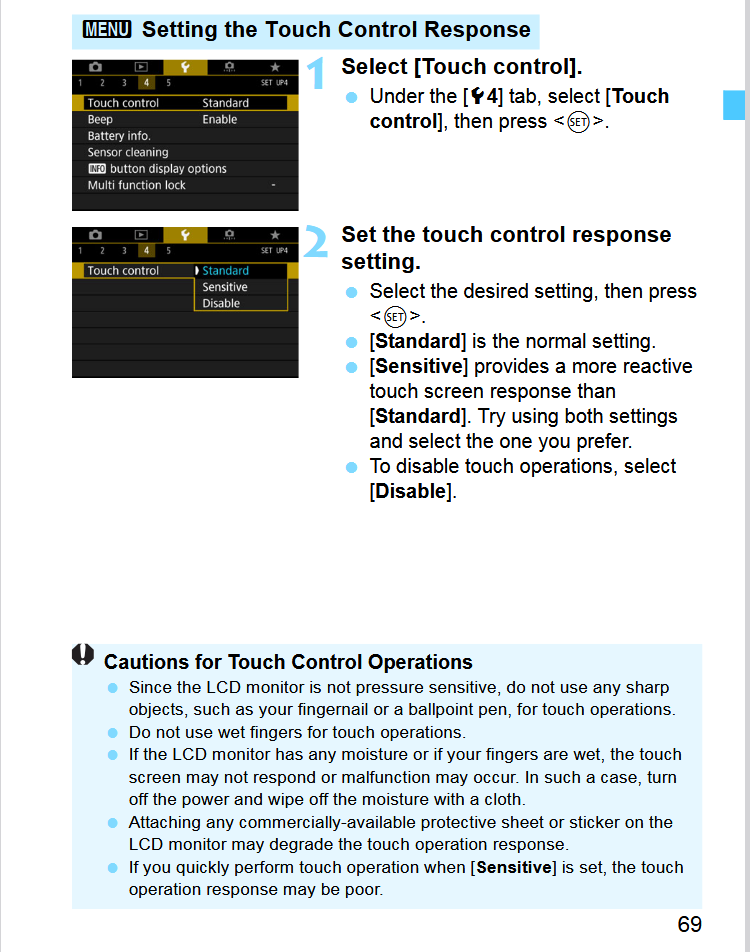

Anonymous
Not applicable
If disabled here it won't work
