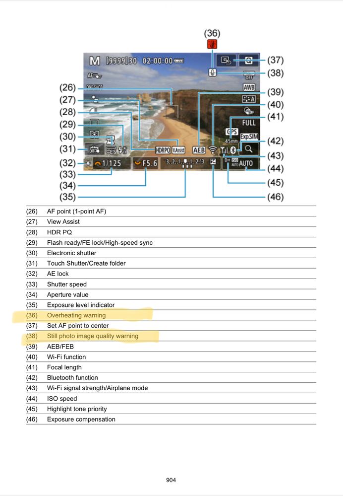

What Stephen described may sound contradictory, but it is not.
The appearance of the White Icon is not unusual. Some shooting scenarios that can cause it appear are desctibed in Stephen’s screenshot.
Icons are in the top right corner. White is a warning. Red is a crisis.
In movie mode, the behavior is illustrated in more detail. The manual seems to suggest that you only get a simple white or red icon in photo modes. However, it is probably the same heat sensing circuitry as photo mode.
In video modes, you could get the white icon and a bar graph, which displays how severe the overheating is. Photo mode may not show a bar graph.
The icon can also change to red, which indicates an imminent crisis.
