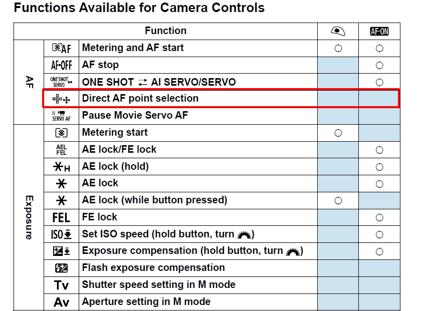

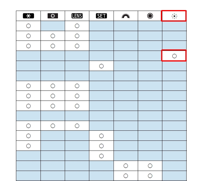

There's a setting in the 90D Custom Function menu (C.Fn III: Custom Controls) where you can program the various buttons and dials on your camera.
Within that menu, there's an option to enable "Direct AF point selection" for the joystick (and rear multi-directional pad). This lets you immediately change your AF point position without first having to press the AF point selection button on the top of the camera or on the rear of the camera.
I have highlighted the steps in RED......
