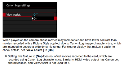

There is not a way for you to apply color grading or a LUT in camera on the R5 to preview footage shot in CLOG3.
Try this. Under CLOG Settings > Menu > Enable View Assist. This will not affect recording to internal media or external HDMI out.

Greetings,
Did View Assist help during review?
