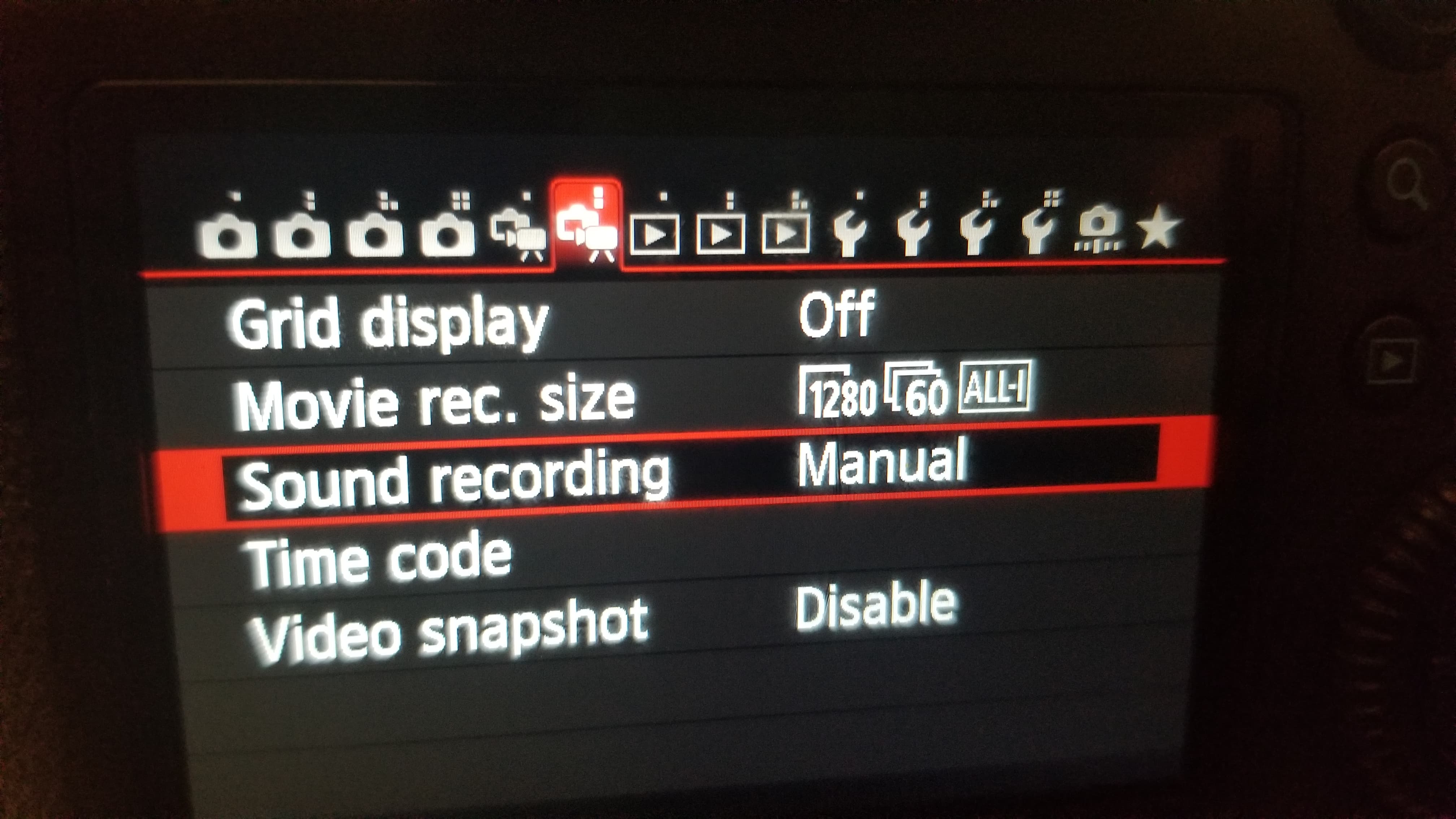

Hello Everyone,

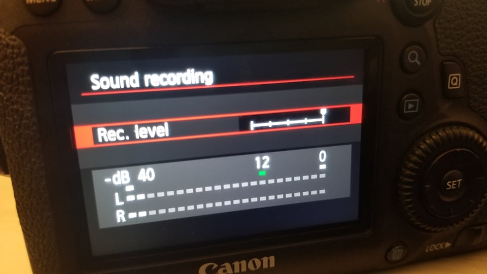

I have a canon 6d, everything is working great except when I record videos the microphone is not recording. I tried going back to factory settings. I tried the manual mode, and changing the volume but when I get to this step it does not register any sound its picking up. I'm not sure what else to do. Any help would be appericated!

Do you see anything on the audio meters?
12-02-2019 11:39 AM
When I go to recordiing volume it is not registering anything, I feel like every now and then I see two bars but goes no further. Semi annoyed b/c I hardly use it and I finally have a use for video and it's not working lol =( I emailed tech support hopefully they have an idea.
