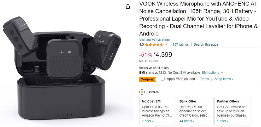

Hi, I need a quick help/guidance to how a wireless microphone works with EOS R50 camera. I connected the receiver using TRS 3.5MM cable which came along with the Vook wirless microphone
The product is working with my Iphone. Do I need to update Firmware or change any sound settings? Pls help!
[Commercial link removed per community guidelines and replaced with screenshot to act as visual aid.]

According to the product page for the microphone it has two cables, one is 3.5mm TRRS and the other is TRS. Your camera needs to be used with the TRS cable - this has three rings on the 3.5mm plug.
Make sure to push the plug in to the camera socket fully - some people have found that they had not pushed it in enough. If you check the camera sound recording menu, you will see the wind filter option is greyed out and cannot be selected when the external mic is correctly plugged in.

The product description for that microphone that you have bought stipulates using this with Android/iPhone cellphones.
Is it possible that Vook has an alternative model that is compatible with DSLR/Mirrorless cameras??
It could simply be a power voltage thing - I would advise you to check back with Vook to confirm specs/compatibility.
