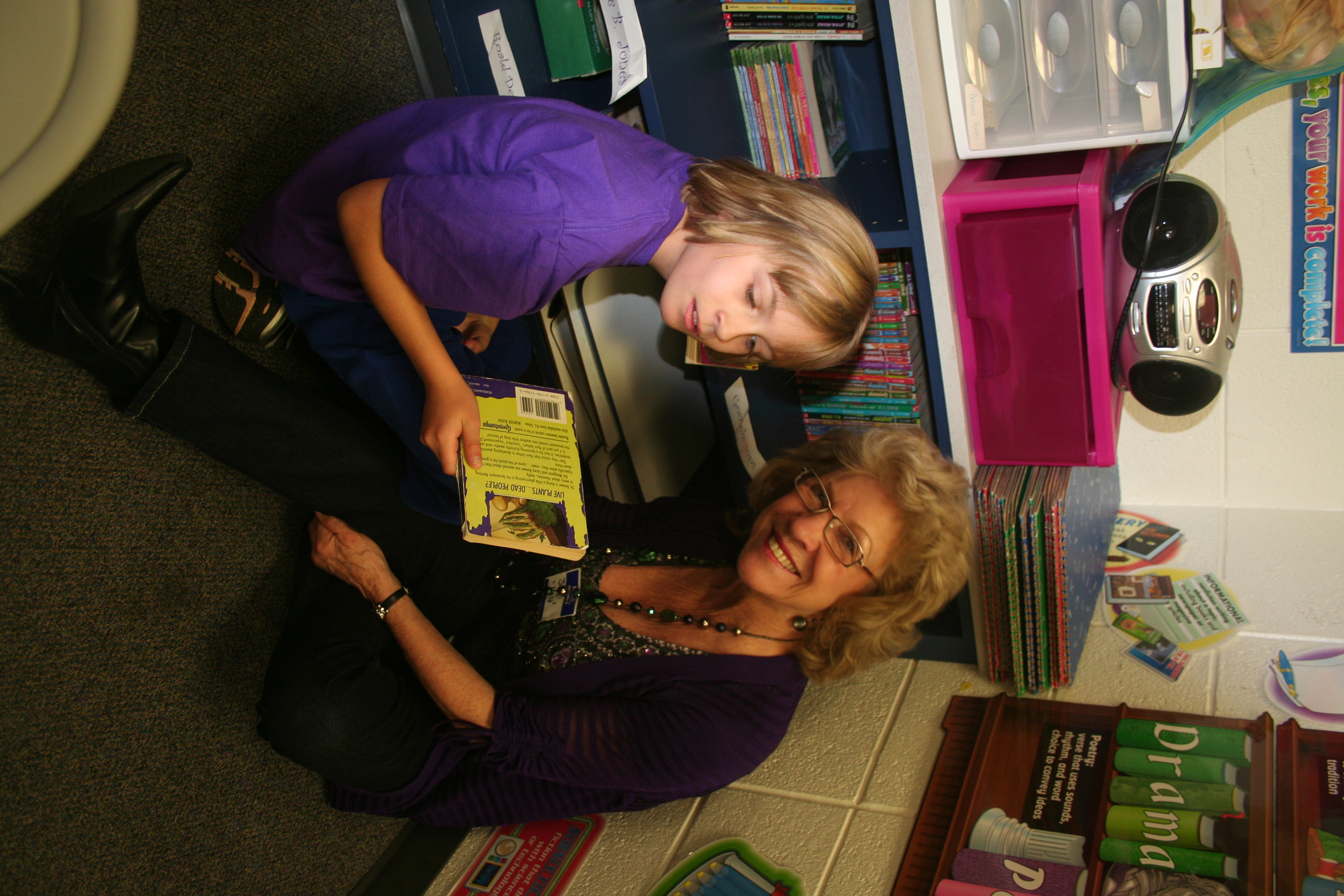

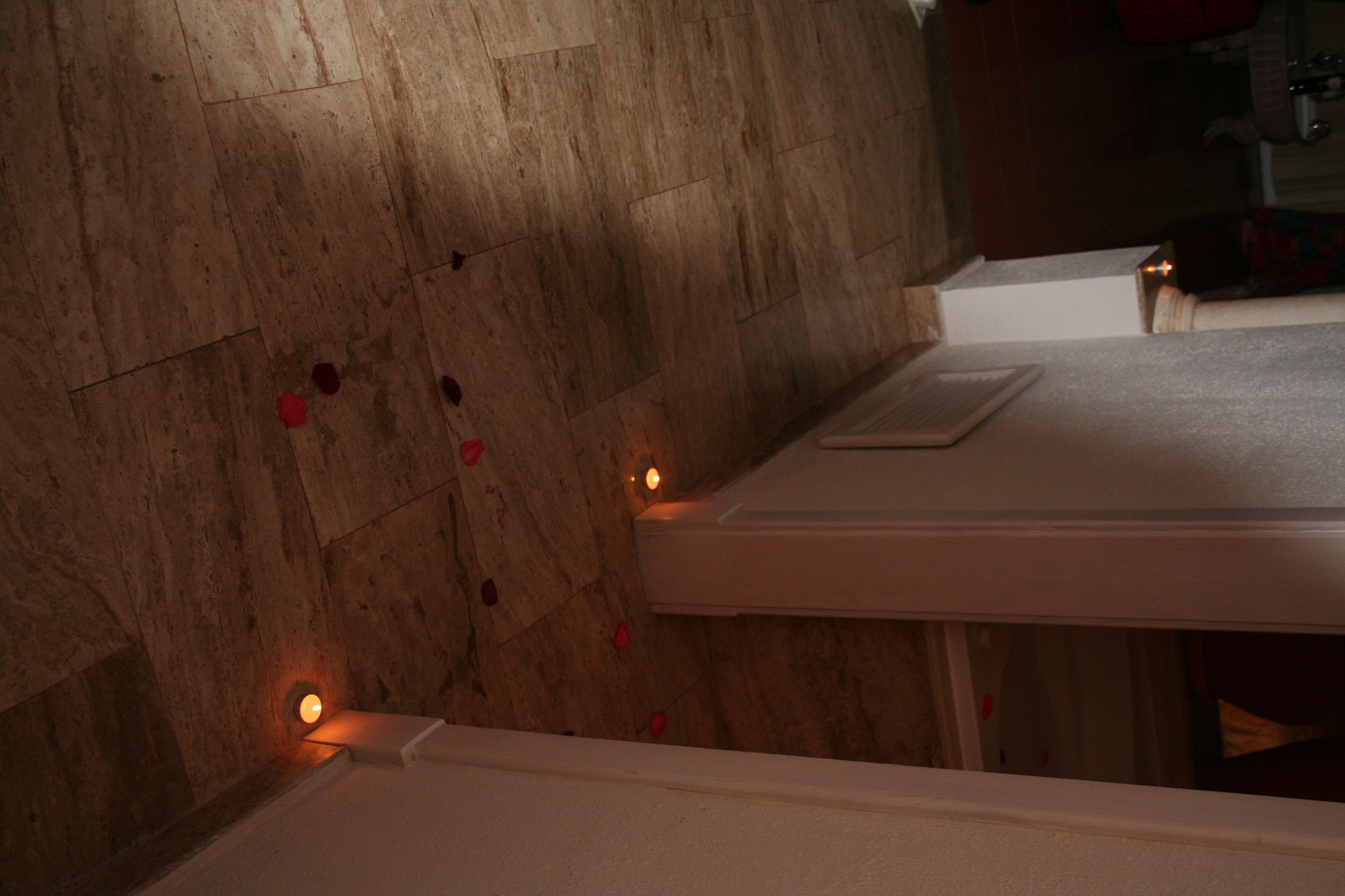

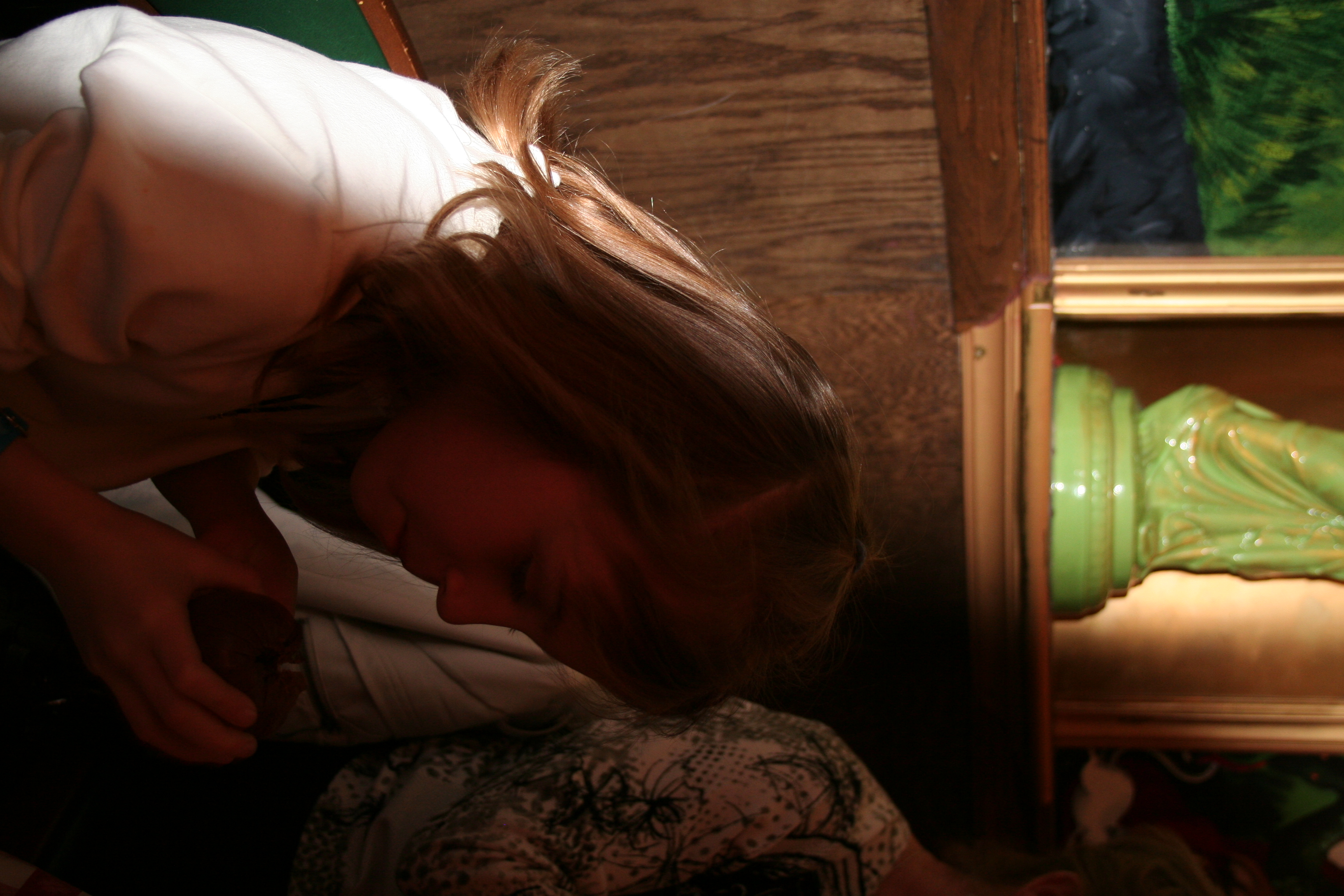

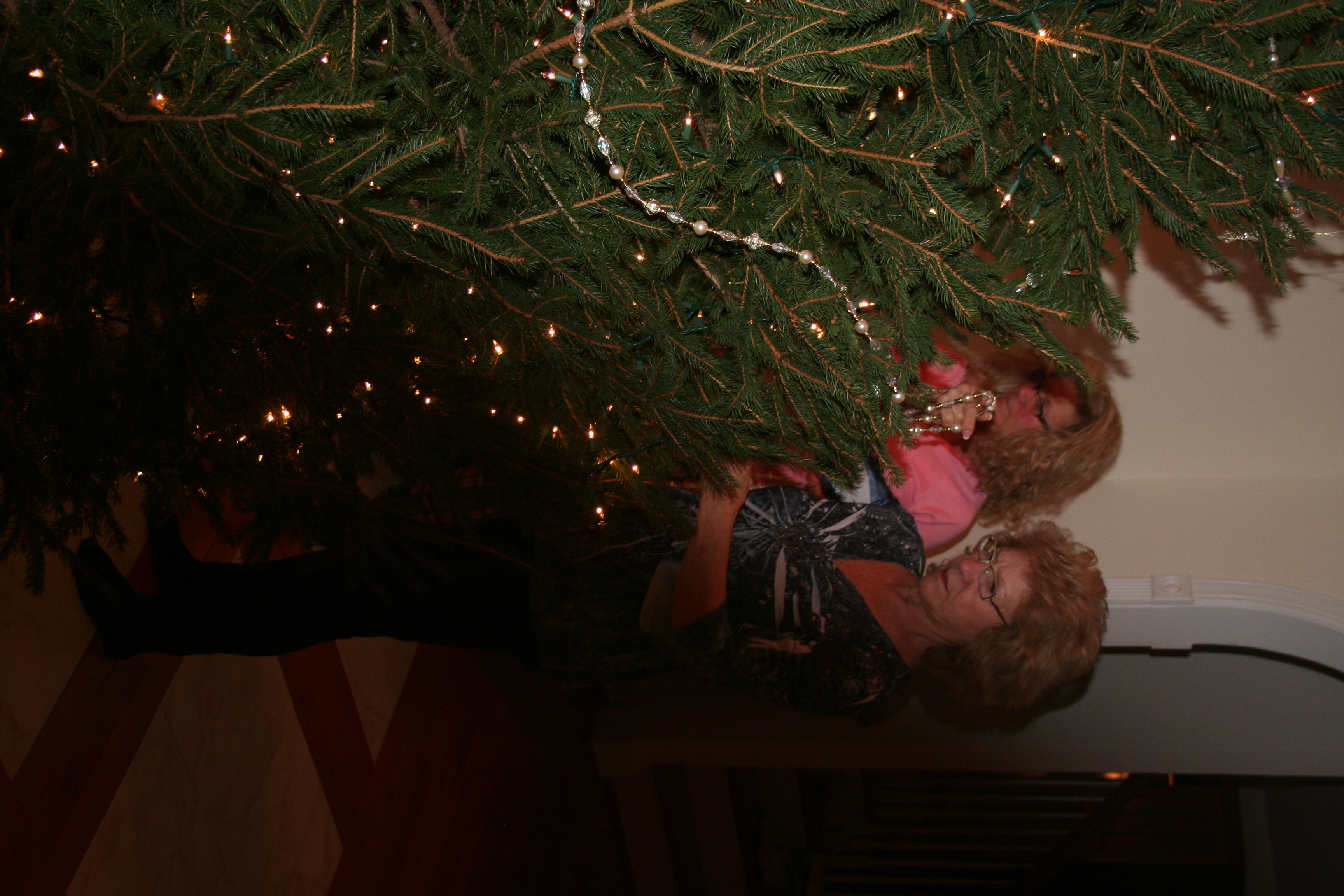

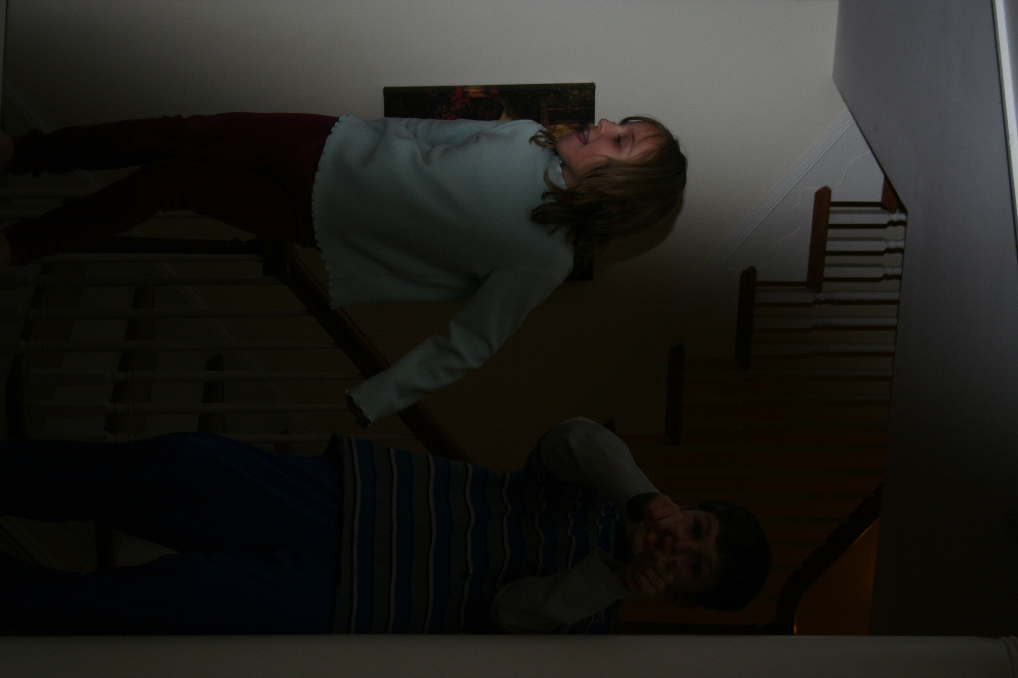

I have a Canon Rebel 350D and I'm using the kit lens 18-55mm. In low light conditions in full auto mode many of my shots are very under exposed in the lower right of the image. The dark area is triangular. Has anyone experienced this and can you explain why this happens?

Thanks for the reply. I believe that for each shot the flash popped up. In many cases it just blinked a couple of times. I will try to attach some examples of phots that show the problem.IMG_3024.JPGIMG_4292.JPGIMG_5226.JPGIMG_5338.JPG

thanks for the reply. I will enclose some exampes of the problem. I believe that when I took the shots the flash did pop up and it blinked a few times before the shutter snaped. I was not using a hood for any of the shots. I hope that you can see that a triangular region - always in the bottiom right is under exposed. any insights would be appreciated.

According to the EXIF data embedded in the photo file, the flash was fired in each of those shots.  That shadow is very pronounced and should not be there. Even with a lens hood on.
I suspect two possible problems:
1) The shutter curtain is malfunctioning and may need to be replaced
2) The flash is somehow malfunctioning and not providing even flash coverage
Can you take a photo without the flash being fired so we can narrow it down?

Well... the good news is it's not the camera sensor and it's not the lens hood.
The shadow actually shows up in a different position in every shot and one image doesn't have any shadow at all (but the EXIF data tells me the flash did fire.)
I'm going to hazard a guess that you're holding your hand around the lens in such a way that your hand is creating the shadow.
When holding the camera try to learn to support the camera from below.    At no point should your hand or any fingers of your left hand be above the lens.
Position your left hand with palm facing up.  Your left elbow should be in so that your forearm is basically bracing from your stomach or ribs up to the camera.  Now you have excellent support -- but also in this position your fingers and hand cannot block the pop-up flash.
